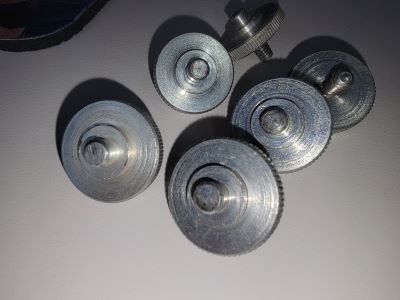

JPG wrote: Mon Jan 16, 2023 8:11 pm The 'issue' of the 510 clamping method(horizontal) is that Image. The clamping screw CAN cause the inner tube to be slightly displaced vertically(up or down) differently on tables being connected. The torque of the clamping screw essentially guarantees that depending upon the lack of a square end on the screw..

There is no guarantee but it is highly likely that the Table Tube will rise to the center position inside of the 510 table rail when lateral pressure is applied by the thumbscrew. However, if we are discussing Main and/or Extension Tables - this in NO WAY effects the positioning of the table tops. If the discussion includes floating tables - yes the table tops may change relative position with respect to the table tubes (by an amount of approximately 1/32"). I don't think this would be significant enough to make Ed in Tampa get rid of his 510.
As for pointed (non-square) thumb screws:
Notice the flat ends on these thumb screws
510 able Thumbscrews.jpg (17.73 KiB) Viewed 4040 times

dusty wrote: Tue Jan 17, 2023 2:40 pm There is no guarantee but it is highly likely that the Table Tube will rise to the center position inside of the 510 table rail when lateral pressure is applied by the thumbscrew. However, if we are discussing Main and/or Extension Tables - this in NO WAY effects the positioning of the table tops. If the discussion includes floating tables - yes the table tops may change relative position with respect to the table tubes (by an amount of approximately 1/32"). I don't think this would be significant enough to make Ed in Tampa get rid of his 510.

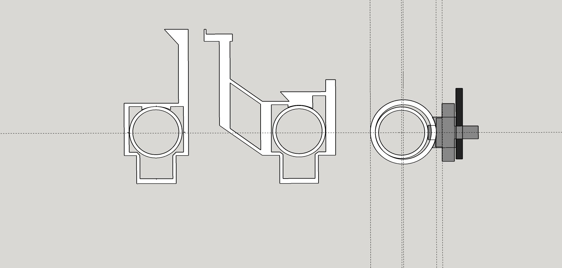

510 and 529 Rails with Table Tubes..a comparison:
510 and 520 Rails with Table Tubes ...jpg (84.94 KiB) Viewed 3912 times
You have to use your imagination for thumb screws on the 520 rails.
The sketch with two vertical center lines shows how much the Table Tube is pushed with the thumb screw (1/32"). Not IMO enough to create a lot of concern Even if the 520 is 0".
I certainly do not believe this movement to be the root cause of the issues that have plagued Ed in Tampa.
I do hope that Scott does another YT video that touches on this.

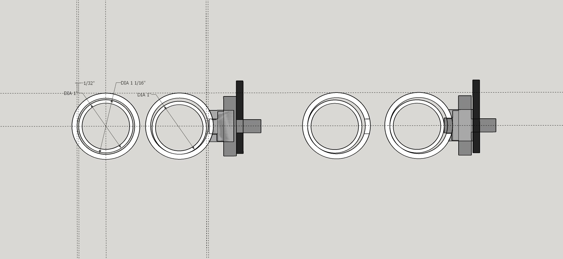

Re: Slop in the Rails Adversly Effects Alignment
Where did 1/32" come from?
Later version has over 1/16" slop.(0.070)
Original version had slightly over 1/64"(0.020)
510 Table Rail with Table Tube Secure and Unsecure.jpg (112.82 KiB) Viewed 3828 times
