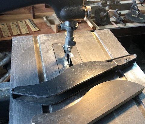

Noted! I left the Upper Guide Bearing alone on the Spring Cylinder. I gave a good WD-40/Scotch-Briting over all the pieces and put them back together - it all runs like a charm now. In the first photo below I have the hold-down spring on backward- since corrected.
Luckily, mine is a later Model A-34 Jig Saw that doesn't seem to need the blocking - which is one less thing I could mess up, heh. My final goal was to saw a shelf holder for my Table Saw Blade Guard; It fits nicely!

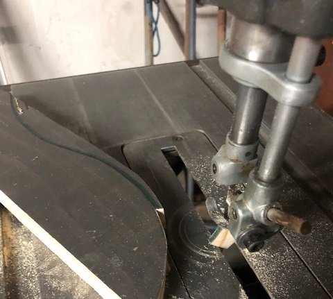

Parting shot: I mucked up the diagonal blade guide a bit -- is it preferable to order a new one or is it so custom that I should instead DIY another?

I believe you are referring to the Blade Guide as indicated by the arrow in your picture below.
_
Scott E Jig Saw arrow.jpg (33.67 KiB) Viewed 5238 times
Although used for both the Model A-34 Jig Saw and the later Model 610/505644 Jig Saw that item is no longer available from Shopsmith. Since the Model 505644 Jig Saw was discontinued most if not all of the parts are no longer available from Shopsmith. If you only "messed up" the very end of the Blade Guide that contacts the Blade itself, you still have plenty of Guide material left. Just cutoff the very end at the correct angle leaving a shallow slot and readjust it against the blade. It's not too short until the end disappears into the mounting hole and can no longer be held by the set screw.

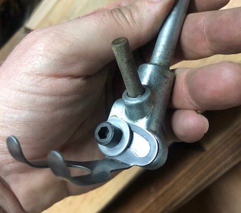

Just curious - what material is it made from?
Scott E.
Posts: 6584
Re: Replacement 10er Scroll/Jigsaw blades
I think the original rods are Phenolic. US Plastics carries it in 1/4" diameter which I believe is correct. Also McMaster Carr carries a large selection of plastic, nylon, resin and UHMW rod that should work fine.

I am pretty sure that a hardwood dowel would work also. Put some wax or oil in the slot where the blade contacts.
