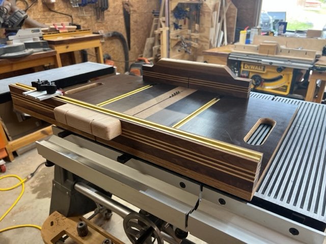

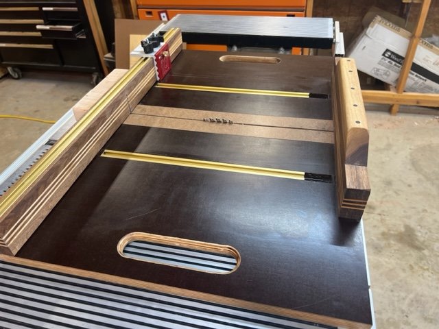

The sled is just about finished. I got it dialed in using the 5 cut method and I am happy with it.
The last thing I want to do is to dye the handguard portion a bright color such as red or orange. I made two shallow cuts into the handguard. When making a cut, my hands will be on either side of the rear fence and covering those two shallow cuts. From there, I can make my cut and know by feel that my hands will be clear of the blade.
It slides smoothly, and should serve me well. If I was to do this again, I would make the fence taller. I am limited to 1 5/8" on blade height.

Looks really nice. How thick is the base and are you concerned that it will limit your cut depth when using the sled?

The base is 3/4" phenolic. I am not concerned with IT limiting the depth of cut, but I think I made the rear fence too shallow. Along with the T Track for the stop block, I have a limit of 1 5/8". Otherwise I will cut into the T Track.
