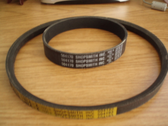

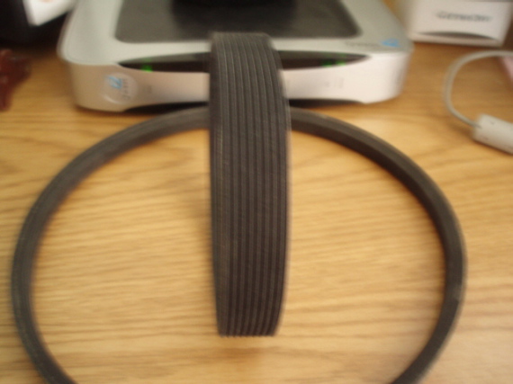

The Mark V is a 1962 model (SN379059). It has not been reported whether it is a Greenie or a Goldie or a Gray Smooth. If it is a Goldie, should it not have a Gilmer.
I thought the Gray Smooth, introduced in 1963, also contained the first Poly-V.
But never fear, this is easy. If your belts look like these, then you have/need 521682 (Drive Belt) and 521681 (Poly-V).
[ATTACH]3888[/ATTACH][ATTACH]3889[/ATTACH]
If you do not have a belt that looks like the one on the right, then you have/need a 521683 (Gilmer).
- Belts 1.jpg (96.31 KiB) Viewed 11395 times
- Belts 2.jpg (93.06 KiB) Viewed 11393 times
'GOLDIES' came in two versions 3/4HP/Gilmer(1960 - 1962), then 1 1/8HP Poly-V(1962 - 1963) in that order.
'GRAY(smooth)' 1 1/8HP/Poly-V (1963 - 1967?).
