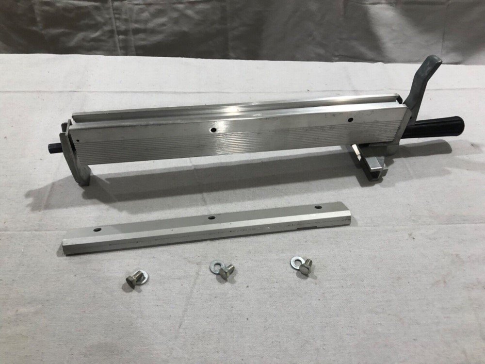

The Bandsaw Fence for the Aluminum Table has had a single lock version (1st picture below) and a front and rear lock version (2nd picture below). Although I have not used the single lock fence, I believe it could deflect some as pressure is pushed against it while feeding the stock through the blade. It would be very difficult to maintain an even pressure against the stock and fence throughout the cut and thereby keeping the thickness the same throughout the cut. Having a Bandsaw Fence with locks on both ends should eliminate that possible deflection problem.

Something unique about the Bandsaw Fence is it mounts backwards having the Fence Rail and Fence Lock(s) on the outfeed side of the Aluminum Table.

None of this applies to the Cast Iron Bandsaw Table which used the Miter as a fence.
