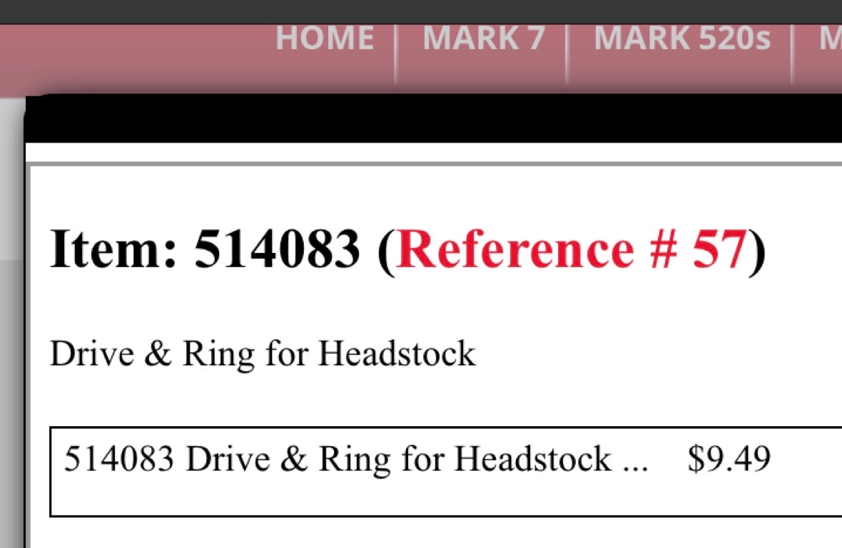

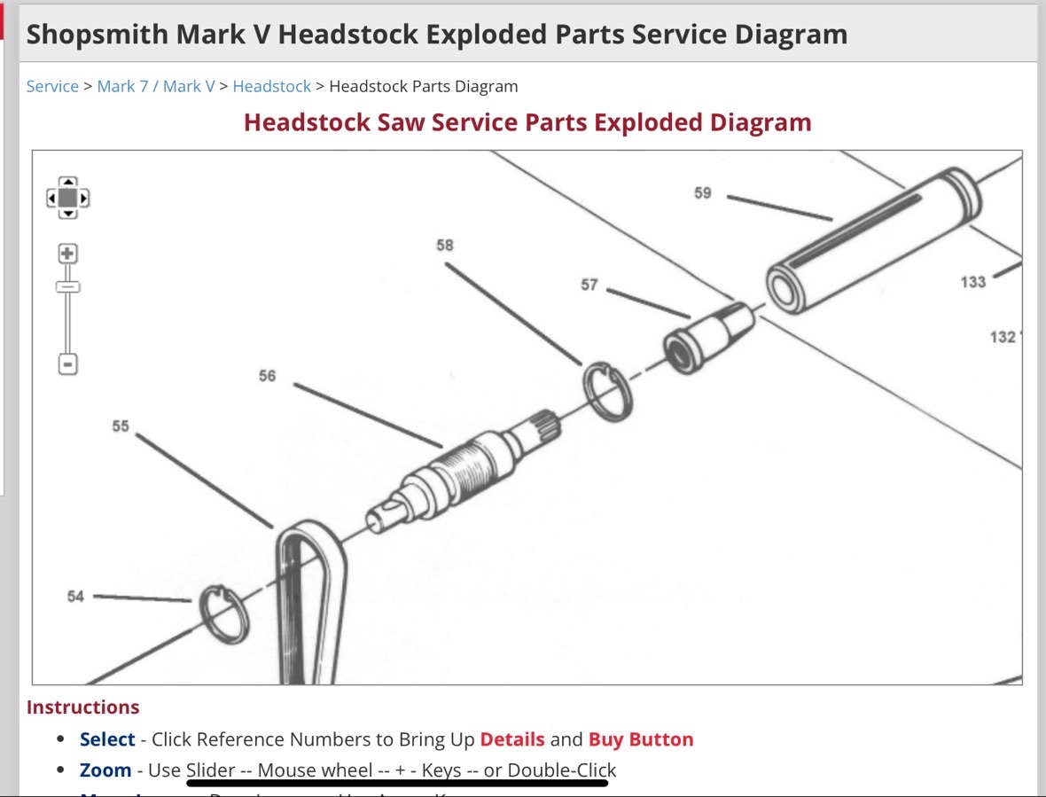

larryhrockisland
Posts: 278
Location: Rock Island, OK
Re: Mark V vibration while turning bowls
Post by larryhrockisland »
viewtopic.php?p=305437#p305437
The tenth post down has a picture of the “drive & ring”. Sometimes it gets worn. Sorry, I cannot get a specific page in a topic to show up.
Below are screenshots from the parts diagrams on SS.
Larry Hargrove
Rock Island, Ok
1957 Mark V 500 (350389)
1953 10ER
Another 10ER
Bandsaw 2012 Jointer 2012
