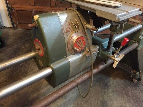

Serial Number 276561 would have been made in August 1954. As JPG said it would have been painted in green and silver with hammered finish paint like the one below.
_
This Mark 5 "Greenie" is a restoration and the paint used was Rust-oleum Hammered Finish Verde Green and Silver. Although a popular color substitute for the original green it is not that close to the original green. Rust-oleum no longer makes the Hammered Finish Verde Green so no longer an option anyway.
Below is a Greenie Headstock with its original paint but keep in mind it is aged and was 59 years old when that picture was taken.
_
I am still looking for a green paint to use on my restorations. I haven't found one I like and Hammered Finish Green paint is hard to find.
