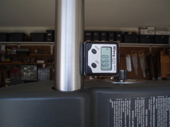

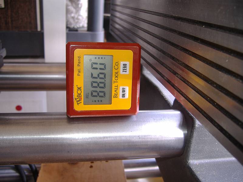

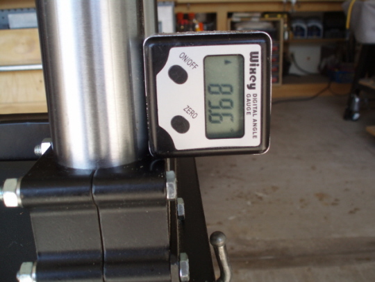

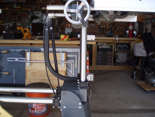

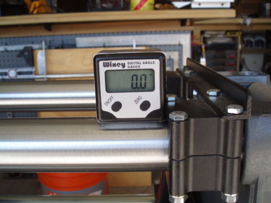

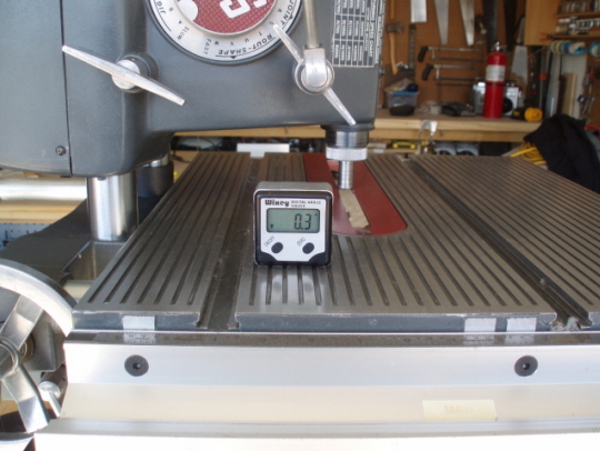

You have already received several answers and this post may very well not add anything to what you have already been assured but here goes nothing.

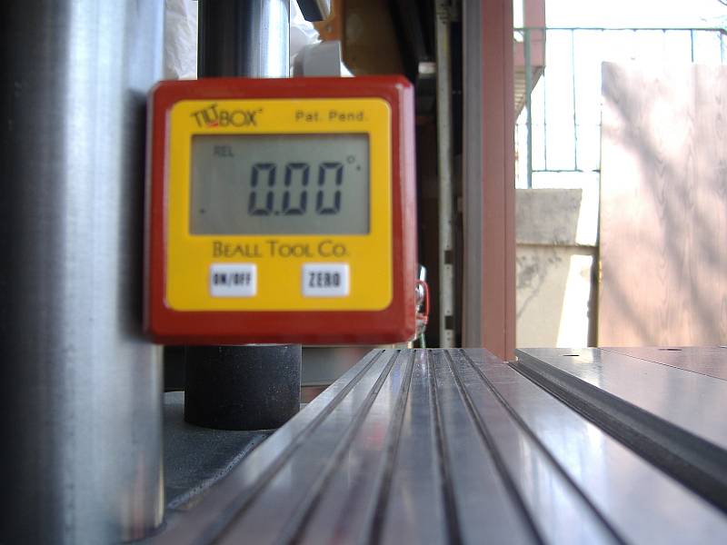

These are pictures of my 510 taken since I read your post. You can interpret but if you have questions please post them.
[ATTACH]3924[/ATTACH][ATTACH]3925[/ATTACH]
[ATTACH]3926[/ATTACH][ATTACH]3927[/ATTACH]
[ATTACH]3928[/ATTACH]

Hi Dusty! I don't own a Wixey - so am a little confused by the readings in a couple of those photos. The Wixey shows angles of 89.x degrees on the vertical way tubes. In reality, isn't the 89 degrees actually 91 degrees? Does the Wixey measure angles greater than 90 deg.?
I thought all Mark V's were designed to over-throw the vertical position for safety reasons. Isn't this true? 91 degrees is what I remember! Same memory as Chris (nuhobby).

Well since I took the picture might as well show them to you too. Mine too is short of 90 deg. The reason this works is where the pivot point is and where the weight is... I will not bother to explain because I'm sure someone will not agree and we will end up with 30 posts of disagreement.
I also will not do the math to see how many inches off relates to degrees off. I know how you guys hate math.
So here are my pictures. Note the machine was vertical then zeroed then dropped down and latched. The degrees you get are what was shown. I will mention that it was on the wheels so the weight in the vertical mode may have compressed them etc etc.
[ATTACH]3921[/ATTACH]
[ATTACH]3922[/ATTACH]

Thanks all for the pics. These pics definitely suggest there is something wrong with mine... Both look like very nice, well taken care of units. Congrats! Perhaps, the newer ones are more accurate in this regard?
