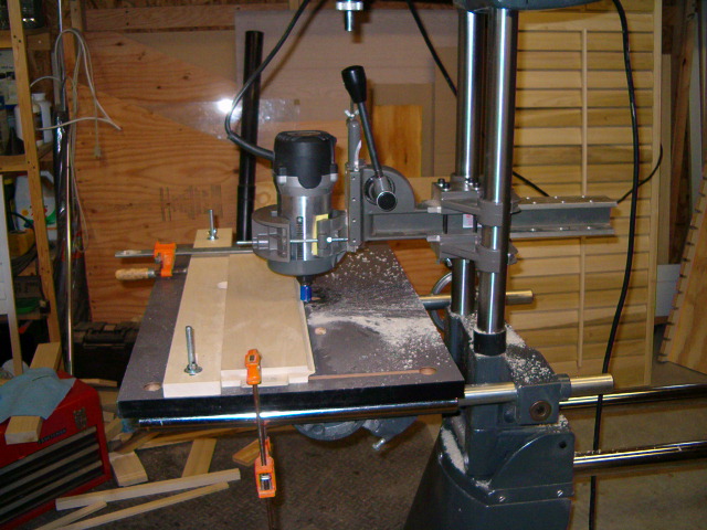

baysidebob wrote:I understand that the OPR system is on sale until midnight tonight. My question is that is seems on all the literature I have seen on the OPR it shows it being used, but I don't see the SS headstock in the picture. It is the OPR system complete, but do you have to remove headstock or how is it positioned in order to us the OPR. Maybe I am just overlooking something. I am thinking of ordering, but looking at options before hand. I know several of you use this system and all comments seem to be good, so I am sure I will get a good answer. THANKS TO ALL......
The headstock will be slid pretty far away from the way-tube pivots, in order to make room for the OPR system. This means the way-tubes are quite heavy when you want to lift it. I read somewhere that the OPR-on-way-tubes was not marketed until the Lift Assist was ready to help with that significant leverage.
On the other hand, I mounted my new-style OPR to a spare Midi Mark V stand, which is 18-19 inches shorter than a normal Mark V, and which has no headstock at all.
Good luck!
Chris
Here's a picture of the headstock on the way tubes. What Ive found is if the headstock is located about 6 to 8 inches from the left tie bar, there is plenty of room to grasp the way tubes and lift the unit to vertical position. Also I mount the OPR in the horizontal mode before lifting. I am not the huskiest old man (75 yrs and 5'6" - 150lbs) and can still do this fairly easily without the lift.
[ATTACH]3996[/ATTACH]
Look at the top of the photo to see the quill of the headstock. If you are wondering what this setup is for - I was routing a short 1/2" dado in a lower shutter stile so the control rod of the shutter would fit into the rail.
