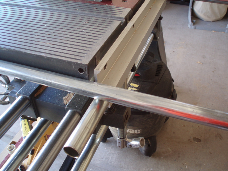

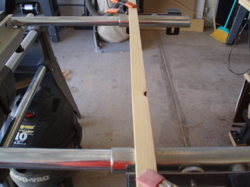

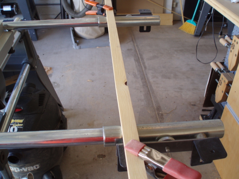

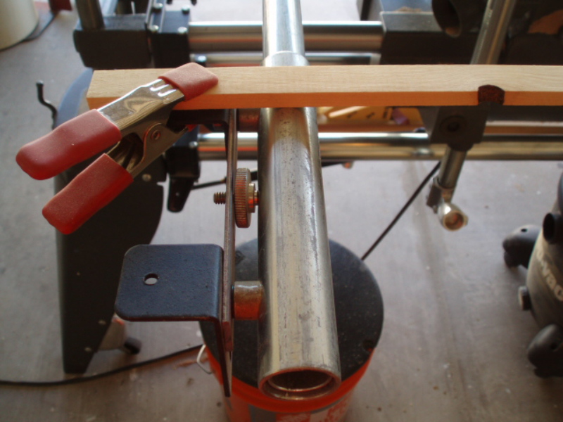

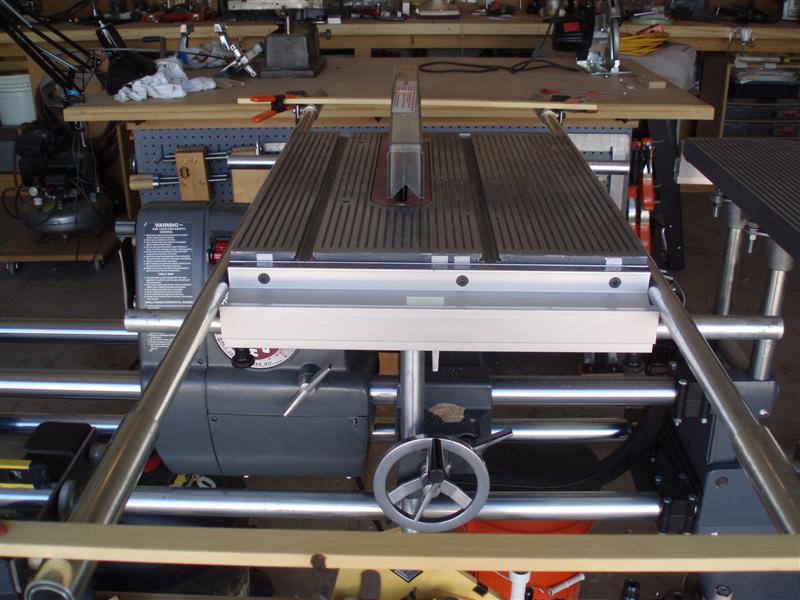

I laid the 5' tubes up on top of some shorter tubes and then installed some of the recycled parts from the 510 upgrade. I attached two pieces of scrap to hold them in place. I can see possibilities. Just replaced the scraps with two properly sized tables and we have it.
Is this sort of what you had in mind for those previously harvested 510 parts?

Ed in Tampa wrote: I like the fact you added you often don't need the tables themselves that the rails suffice. In light of this I was thinking that instead of using 3/4 melamine for tables whether 1/4 ply might not work or even some aluminum cross members.
I know you had this engineered by friends but I tend to think it is probably stout enough to support an engine block. :p I would like to see if your brilliant idea could be engineered using more common stock and less huskier and therefore lighter material.
I considered 1/4-in and 1/2-in plywood for the tables. I choose the 3/4-in material so I could cut dados to match the miter slots. I also thought that 1/4-in ply might sag more than I wanted, being supported only on the edges. I cut the dados, by the way, deeper and wider than necessary, so I didn't have to worry about precise alignment. They are just to prevent interference with the miter gauge bar.
My prototype used 1x4s for the rails instead of the aluminum channel. I had to notch one of them over the headstock, but reinforced that area with some smaller aluminum channel. That rail still broke at that point.
As for the weight, my biggest concern is that all of this is supported by the two main table posts, which are supported by the aluminum casting of the carriage, and weight sitting out on the tables has a lot of leverage. I suspect that if I just leaned on the end of the table too hard I could either bend one of those table posts or crack the carriage casting. I have tried hard to not confirm that suspicion. :)
