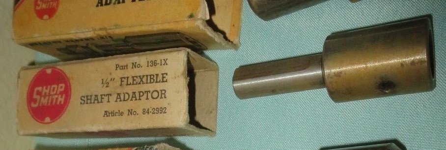

Hi Ed,
I know the Dremel Flexible Shaft you are talking about. I have 1 with my collection of Dremel tools. I don't know of a way to use the Dremel Flexible Shaft on the Model 10's or other Shopsmith tools like the Mark 5. It would take some kind of a custom-made adapter to do it. The Dremel Flexible Shaft has a collar that attaches to the outside case of the Dremel tool that keeps the outer sheath from rotating. The outer sheath of the Shopsmith and other brand Flexible Shafts are held from rotating by the user. Not a problem when the Flexible Shaft is properly lubricated.
The Flexible Shaft Adapter I mentioned in my previous post is shown below.
_
Part numbers 136-1X and later 12 329
136-1X Flexible Shaft Adapter.jpg (82.6 KiB) Viewed 16150 times
Due to the size of the Shopsmith/Magna Flexible Shaft I would stick to the Dremel Flexible Shaft for detailed carving and engraving.
