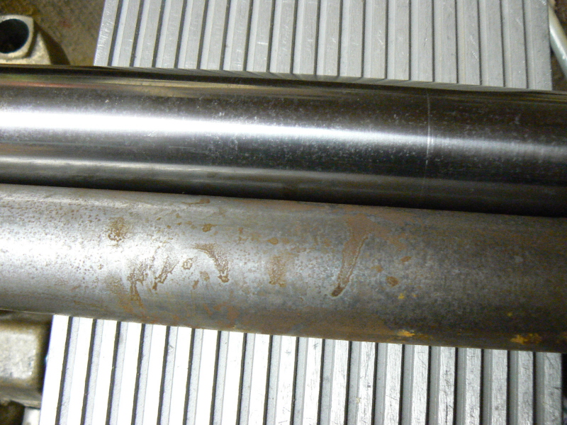

To continue the saga of my 10 e/r tube 'restoration' I post the following:
[ATTACH]4376[/ATTACH]
This is one tube 'polished' and the other b4 polishing. I had left them both OUTSIDE in rainy weather for over a week! The coating of Evaporust(for the most part) prevented new rust.
[ATTACH]4377[/ATTACH]
This is both of them after polishing and preliminary waxing(not entirely rubbed down). There is still some very light pitting which I decided to leave so as to not remove too much material. I can always sand it down later. I cannot put it back on.

JPG40504 wrote:To continue the saga of my 10 e/r tube 'restoration' I post the following:
See later post for polishing method/setup/hardware.
They look better than mine and mine have never been rusty. Good job.

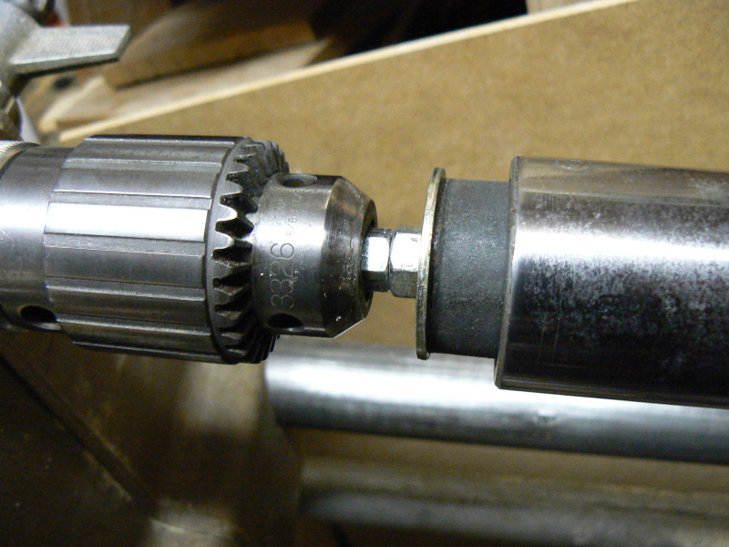

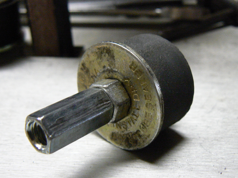

This post shows the methodology used to sand/polish the 10 e/r tube I am 'restoring'.
The method used is a combination of what Bill Mayo has illustrated as well as a 'chucking' method ala Mickyd. Bills's method requires a SS and a 3/4(?) jaw chuck. Mickyd's chuck was used with a variable speed drill since he did not have a working SS(Yet).
[ATTACH]4378[/ATTACH]
This is the 'freeze plug' used as a chuck. I added a threaded coupler to screw onto the expansion bolt. It is then placed in the SS drill chuck.
[ATTACH]4379[/ATTACH]
This shows the 'plug chuck' mounted into the ss drill chuck and the tube about to be slid onto it. The tube is inserted over the plug and the nut on the expansion bolt tightened and the bolt then tightened into the threaded coupler.

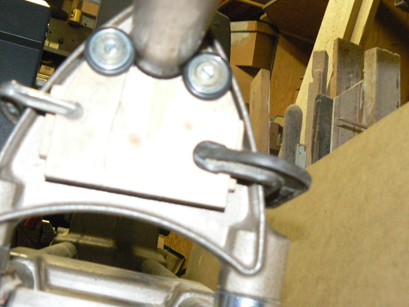

[ATTACH]4380[/ATTACH]
This shows a setup similar to Bill Mayo's tail stock support. The idler pulleys are crudely mounted and are smaller than Bill's. The idler pulleys used are described below.

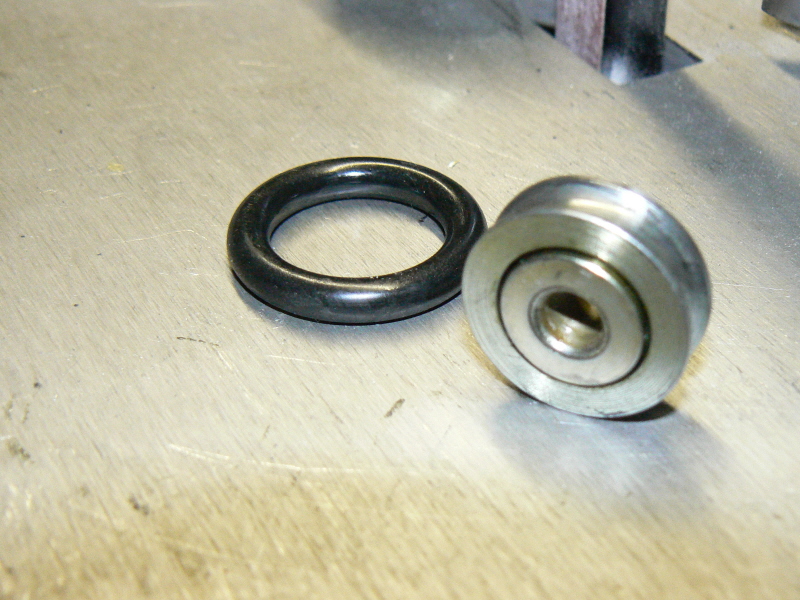

[ATTACH]4381[/ATTACH]
The idler pulleys consist of a sliding storm door glide with ball bearings and an outer groove. Into the groove is slipped(tightly) a 3/16" o-ring. Two of these were screwed on to a peice of scrap wood. This piece of wood was spaced out over the tail stock boss around the hole with another peice of scrap and c clamped to the tailstock.

dusty wrote:They look better than mine and mine have never been rusty. Good job.
Cameras are KIND at this range. They take a better picture than what we see with our eyes.

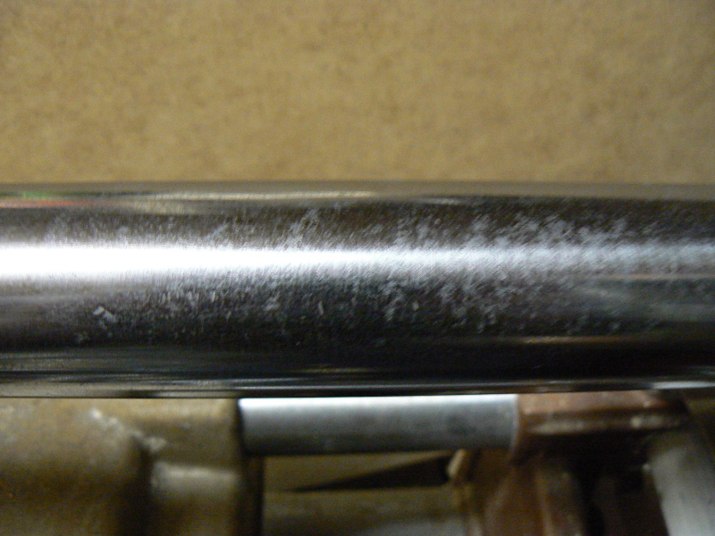

[ATTACH]4382[/ATTACH]
This is a closeup of the 'pitting' I decided to ignore for the time being!

JPG40504 wrote:This post shows the methodology used to sand/polish the 10 e/r tube I am 'restoring'.
I LIKE IT JPG!! The hex spacer screwed onto the expansion plug bolt is a GREAT idea. I chucked directly on the threaded section which is not as good as this method. Good documentation!
Sunny San Diego
mickyd wrote:I LIKE IT JPG!! The hex spacer screwed onto the expansion plug bolt is a GREAT idea. I chucked directly on the threaded section which is not as good as this method. Good documentation!
Thought you might like it.;) I thought it was pretty slick!:D Sure is easier on the bolt threads!:) This idea hit me when I encountered the threaded coupler while looking for something else in the hardware store.:p
