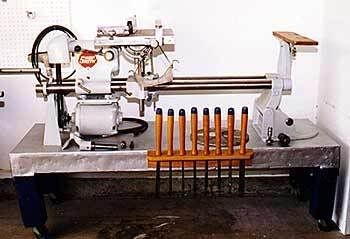

I saw a picture of a white 10ER a while back and thought it looked very handsome, so I saved it. Here 'tis. Alec

easterngray wrote:I saw a picture of a white 10ER a while back and thought it looked very handsome, so I saved it. Here 'tis. Alec
Shopsmith 10ER
Sure it is NOT a food processor?:D

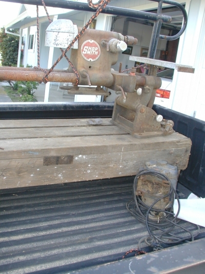

I just picked a 10ER for free from a professional cabinet maker who used it for horizontal boring and said it was great for that. Here is the current sorry state of affairs. No table, all gunky BUT am wondering if the tubes are the same dimensions as a Mark V so I can put together a Shorty.
As you can see the 1/2 HP motor is disconnected, frayed, but works if I "jiggle the two wires into the hole". Gadz
Now to search about rust removal. It may come to "who wants what" if SWMBO keeps reminding me of the mundane things......

Len wrote:I just picked a 10ER for free from a professional cabinet maker who used it for horizontal boring and said it was great for that. Here is the current sorry state of affairs. No table, all gunky BUT am wondering if the tubes are the same dimensions as a Mark V so I can put together a Shorty.
The length and outer diameter are the same as Mark 5/V, but they are heavier(thicker wall). I feel it would be a shame to cut them.:( :eek: Better to cut some Mark 5/V tubes instead.;) :D

[quote="JPG40504"]The length and outer diameter are the same as Mark 5/V, but they are heavier(thicker wall). I feel it would be a shame to cut them.:( :eek: Better to cut some Mark 5/V tubes instead.]
I believe you, but must ask why?
Today went to Harbor Freight on got that Evapo Rust and we'll see after I bath them in it. Besides I don't have a Mark V given to me for free....unless.....naw, never mind, but thanks for the info

Len wrote:I believe you, but must ask why?
ER tubes are a lot harder to come by. Mark V tubes aren't as difficult to obtain. And since they have thicker walls and are heavier, they're considered higher quality than the Mark V tubes by many people.
You gotta do what you gotta do and nobody's going to hold it against you, but I agree with JPG that it would be a shame to cut the ER tubes.
