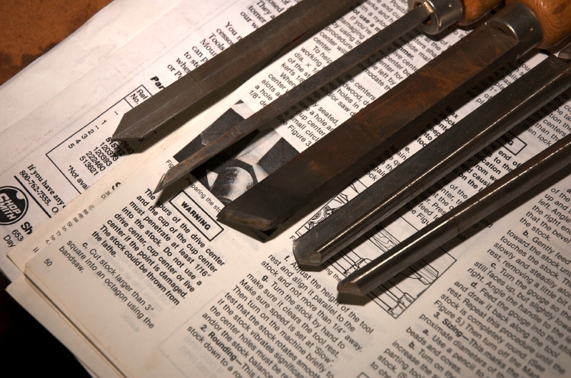

Below are some photo's of the lathe tools for your reference.. I think I've got two gouges, a roundnose chisel, a skew chisel and a parting tool based on reviewing the PTWFE Lathe chapter
[ATTACH]4226[/ATTACH]
[ATTACH]4227[/ATTACH]

Looks like the two gouges are a
3/4inch roughing gouge.
3/8inch spindle gouge.
I'm guessing that they are carbon steel, which means you'll have to be careful when grinding them so they don't get to hot and take out the temper.
WHAT kind of spark do you get when ya touch em to the grinding wheel?
On the skew, round over the square edges on the shank, so it slides better on the tool rest.
OH and Rockler might sharpen them for ya, for a price.

The only one half sharp is the one on the far left in the bottom photo -- the parting tool--perhaps due to lack of use.. As for the grinder, I've not yet tried using it so I've got no ideas on spark color which I gather ought to be white possibly (as opposed to orange/yellow)...

The chisels in your picture look like the original set that comes with the shopsmith. If so, they are carbon steel which means that they can heat up quickly when sharpening so you have to be careful with them and keep cooling them off, however they are decent chisels and work fine when sharpened. I still use my original 3/4" gouge to do my initial roughing of whatever I may be turning and never have a problem with it when it is sharp. I use bowl gouges for hogging out the inside of bowls and shopsmith makes a good one that is HSS steel and also use some Sorby chisels. Below are some angles recommended by a former Shopsmith TA instructor to put on the chisels for good results. He had given the degrees for using the Shopsmith sharpening jig and the other number is the angle you would use on a grinding wheel.
I have mine set to these angles and like the results. Other turners have other angles and like theirs, so it's a matter of whatever makes you feel comfortable and gives you good results.
So the angles would be as follows.
Gouge...13 degrees left of 0. = 32°
3/8" Gouge...5 degrees left of 0. = 40°
Skew...13 degrees left of 0. = 32°
Parting...8 degrees of left of 0. = 37°
Scraper...0 degrees. = 45°
Bowl Gouges...4 degrees left of 0. = 41°
