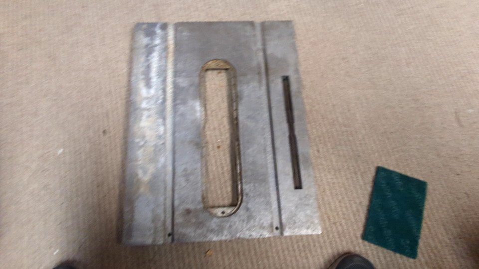

Now the table top. I decided to try the Brasso an Scotch bright method. This is what it looked like before I began.
After about an hour of elbow grease, this is where it is at.
It is a definite improvement, but I think I can do better. I have some Mother's Mag polish that I might try on it.

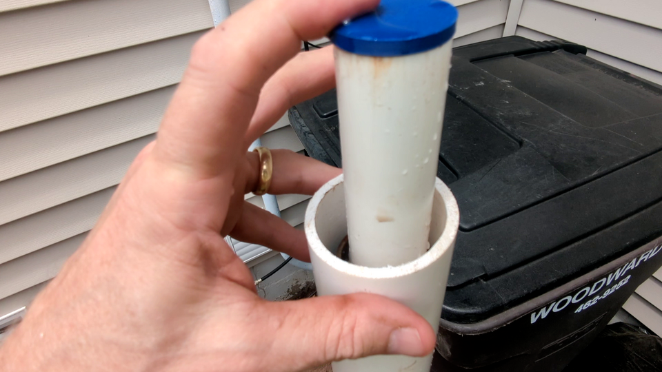

So now we turn our attention to the base and way tubes. Looking over the forum, I decided to go the 2" pvc pipe with the 1" pvc pipe in the middle. Mine isn't that different then the other examples that have been shown on here, but I did 3D print plugs for the 1" pipe. If you just go out to Menards and get a couple of caps, they won't fit in the tubes.

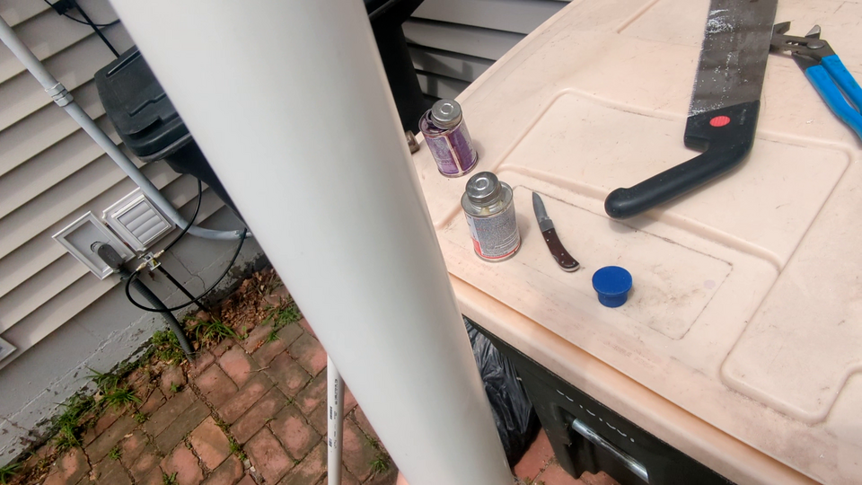

So this is what I came up with. It is printed using PETG filament, which is the same stuff they make water bottles out of and I found out you can use regular pvc cement to glue them to pvc. They are blue, because I had some blue filament I needed to use up.
I cut the main pvc pipe to 54" and the 1" pipe to 53 3/4" inches to account for the width of the cap. This allowed the top cap to hold the inner pvc pipe down into the solution.
Quite a bit of buoyancy on the inner pipe.
This is the top cap I used.

I like the 1" insert you made for de-rusting the Bench and Way Tubes which will require less rust remover. I don't have that 1" insert and it takes about a gallon to fill the tube. Another less expensive alternative is white vinegar for rust removal. It does take longer, about three days.
