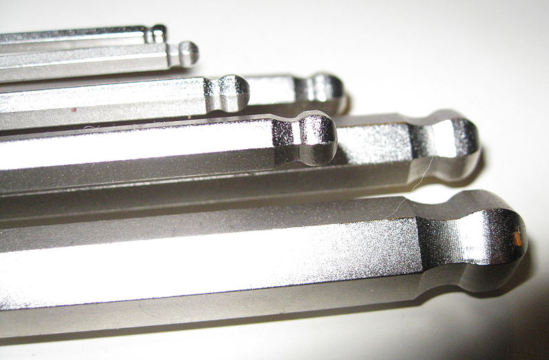

JPG40504 wrote:The 'cursed speed dial set screw' becomes less of a PITA if you use a straight allen wrench with a screwdriver like handle AND have previously glued a straw with one end over the set screw and the other end around the access hole!
I use ball end hex keys and have never had any problem finding the set screw hex.
