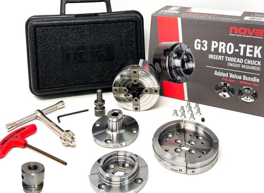

Okay with everyone's input considered.
I am starting to see a little (Light at the end of the tunnel) on these Chucks.
Thanks for Y'all's help. :cool:
After studying the suggestions.
I am debating this one in the link below.
Link: https://www.amazon.com/Nova-Pro-Tek-Sta ... =UTF8&th=1
Dwayne
RFGuy
Posts: 3101
Location: a suburb of PHX, AZ
Re: Vinwox 4" 4 jaw chuck?
Post by RFGuy »
I still consider myself a novice at woodturning, but have produced several bowls and salt & pepper mills that turned out well on this chuck. I have the original Nova G3 chuck and I have been happy with it the past few years. The Pro-Tek is just a newer version as I understand it. We discussed what was different with the Pro-Tek version in the thread linked below. Biggest change is essentially they changed the tighten/loosen direction. For some this will come more natural now, but for others be a pain - depends on whether the jaws are clamping down on something to hold or need to expand to grip the inside of a tenon, e.g. on bottom of a bowl, etc. One downside with the newer Pro-Tek version is they use star fasteners to hold the chuck jaws on, whereas the old one used 5/32" hex ones. I have the original G3, so that is one perk, IMHO, because I can use the same 5/32" hex wrench from my Mark V with the Nova G3. It really isn't a big deal because you don't take the jaws on/off that frequently though.

I'd strongly suggest that you buy one with the t-handle tightener, rather than the two 'tommy bars'. I have one of each and really dislike having to use the two bars to lock the workpiece.
A problem with tommy bars it it requires two to get the job done.
One them always seems to get lost when you need to use them.

pngeezer wrote: Wed Aug 21, 2024 12:00 pm I'd strongly suggest that you buy one with the t-handle tightener, rather than the two 'tommy bars'. I have one of each and really dislike having to use the two bars to lock the workpiece.
This is kinda what I am looking for.
As a Machinist I am familar with Metal lathe chucks.
Just not familar with wood lathe chucks yet.
Is this the key to the Nova G3 chuck in the second link I posted?

JPG wrote: Wed Aug 21, 2024 9:40 pm A problem with tommy bars it it requires two to get the job done.
I can Totally understand This. :rolleyes: :rolleyes: :D :)
Dwayne
GetterDone wrote: Wed Aug 21, 2024 10:54 pm
YES

Post by GetterDone »
JPG wrote: Wed Aug 21, 2024 11:38 pm
YES
Thanks.
As far as I can tell from the pictures. :)
I think I am going to like this one.
