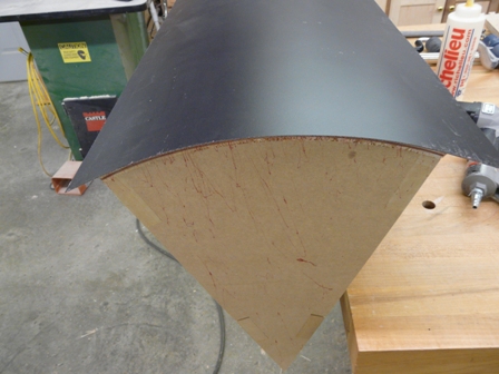

I did manage to get a little done this is a picture of a 4 x 8 sheet of the bending plywood.
[ATTACH]4430[/ATTACH]
This is one of 2 layers of bender board clamped up. I have learned that in radius work to use lots of glue and clamps.
[ATTACH]4431[/ATTACH]

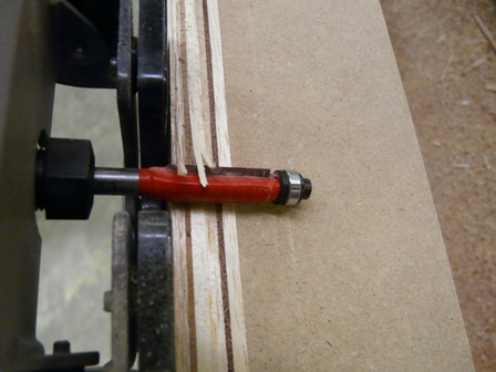

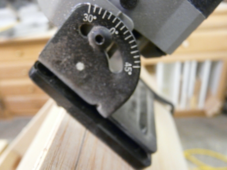

I use a trim bit with a tilt base router set at 5 degrees to trim the binder board. This will cut it a little long and later I'll sand it flush.

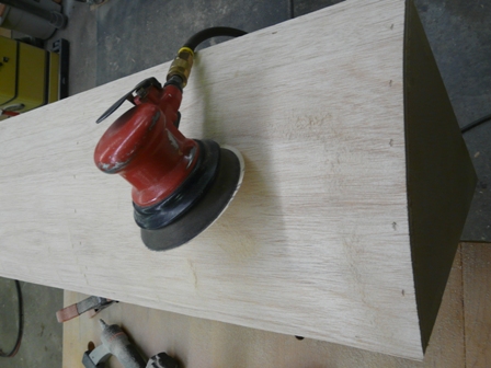

Before starting the laminate sand with 80 grit to get a smooth surface.
[ATTACH]4460[/ATTACH]

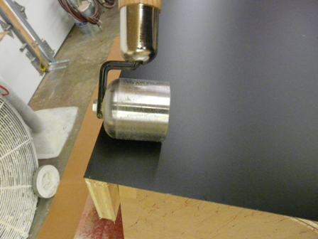

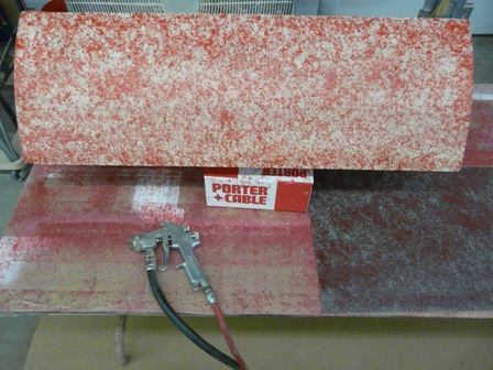

I use spray grade contact cement. It will spray in a regular cup gun but not a gravity feed gun. Here I am using a 2 gallon pressure pot.
[ATTACH]4461[/ATTACH]
I have cut the laminate 2 inches over sized both on the height and width. Here to start the sticking process I clamp a piece of scrap plywood along the starting edge. This will give me 3/4" to route off and insure the laminate is on straight. Once it sticks it is stuck! It better be right.

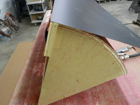

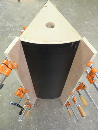

[ATTACH]4462[/ATTACH]
[ATTACH]4463[/ATTACH]
Now I roll the laminate down.
[ATTACH]4464[/ATTACH]
After trimming I re-set the clamps and boards. I'll let this set overnight.
Mark

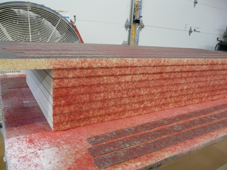

[ATTACH]4469[/ATTACH]
Cabinet ends stacked and glued along with edge banding strips.
[ATTACH]4468[/ATTACH]

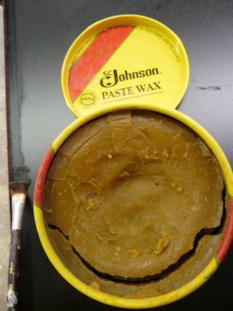

After edge banding is stuck I'll apply past wax before routing.

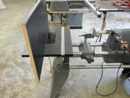

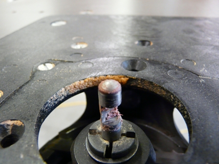

This is a solid carbide trim bit. I prefer it over the bearing type for laminate.
[ATTACH]4471[/ATTACH]

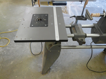

This is one of my favorite Shopsmith accessories.
[ATTACH]4472[/ATTACH]
I will trim all the smaller pieces on this set up. It is faster and easier than the hand held trim router.

You said that you apply paste wax before completing the edge band routing.
Am I to conclude that you believe you get a smoother cut after waxing?
I have that router table too but someone cannibalized a t-track from mine. I think it might be in an outfeed table now.
- Posts: 1627
- Location: Greer SC
The wax keeps the solid router bit from burning or marking the plastic laminate. I don't like to use a bearing bit for routing plastic. I have had a number of problems with them ranging from the cutter cutting proud or the bearing to the bearing actually coming loose and ruining the piece. Also the bearings are bad to build up with the glue over spray. You have none of these problems with the solid carbide bits but you have to protect the laminate with the wax. It all has to be cleaned up with lacquer thinner anyway to remove the glue over spray and wax.
Mark
