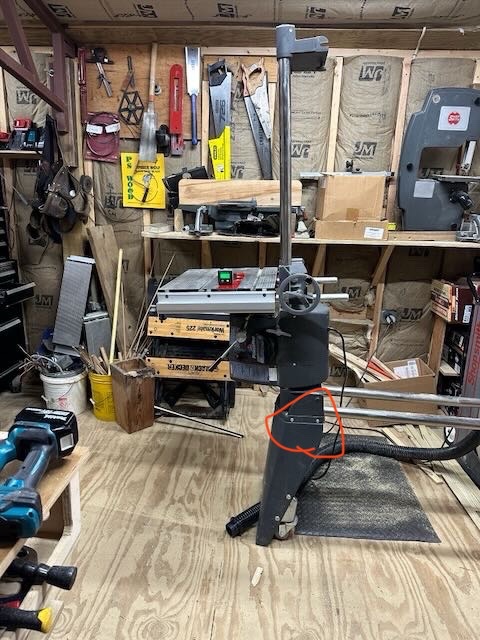

DLB wrote: Sat Sep 21, 2024 2:16 pm From the pictures, which may be introducing some perspective error, I think the problem is where the lower Base casting mounts to the Bench Tubes. It appears to me that the whole assembly, left leg and all, is at the wrong angle to the Bench Tubes. One of a few possibilities is that the mounting bracket was overtightened at some point and perhaps crushed the Bench Tubes near the end.
I see you have an angle cube. And I presume that putting the machine in the traditional vertical position (with the motor above the table) does not create an over-rotation condition at the right end. So my suggestion is to measure one or more planes on the lower part of the Base casting relative to the Bench tubes and see if they differ between the two Base Castings. This would confirm or refute my observation above.
It has been pointed out by someone on the forum that ordered new bench tubes that Shopsmith changed the design. 'Newer' tubes (no idea when this change was made) are stainless steel and have thin walls. They should have inserts neat the ends that are meant to prevent crushing the tube when clamping them into the Bases. Since your machine looks fairly new, it may have these newer Bench Tubes.
Good catch! This line should be horizontal
Mark V 510 51-014654
Re: Mark 7 - Under Table Routing Alignment
The angle that appears to to me be unusual is the legs beirng near vertical. They should be splayed out more.
I am not familiar with the new double tilt base assemblies, but wonder if the bench tubes are not resting on the correct contact point near the end.

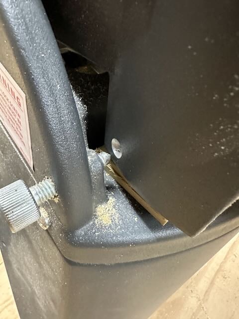

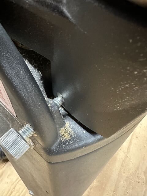

Attached are pictures of locking screw.
Shimmed Lock Screw.jpeg (73.57 KiB) Viewed 2943 times
this one is shimmed and does not align with the divot.
Not Shimmed Lock screw.jpeg (68 KiB) Viewed 2943 times
and it does align with divot.
David good eye - The support leg is out of alignment by about 5 degrees. Will try to disassemble later this week and see I can correct. I will report back. thanks

Hard to tell from the picture. The lock screw is not supposed to center in the divot. The conical end of the screw should only contact the side of the divot. It is not supposed to reach the bottom of the divot. It is supposed to push on the side of the divot as it is tightened.

"Not shimmed" looks correct to me
Not shimmed looks over rotated to me.
Shimmed looks closer(not quite) to normal.
Camera angle may be misleading.
