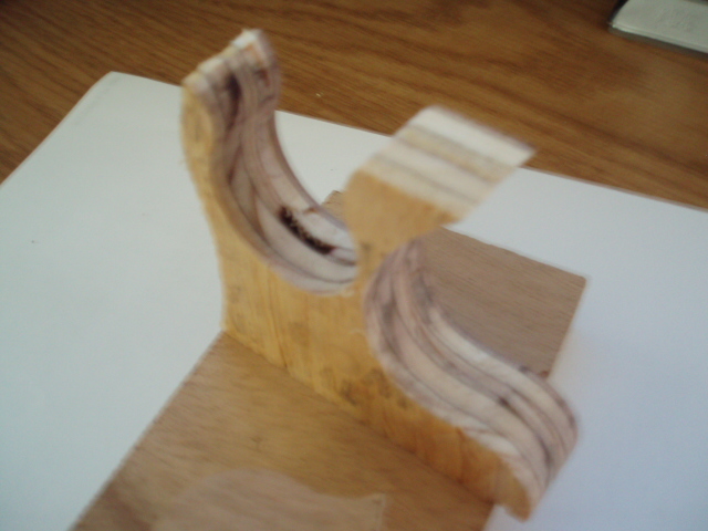

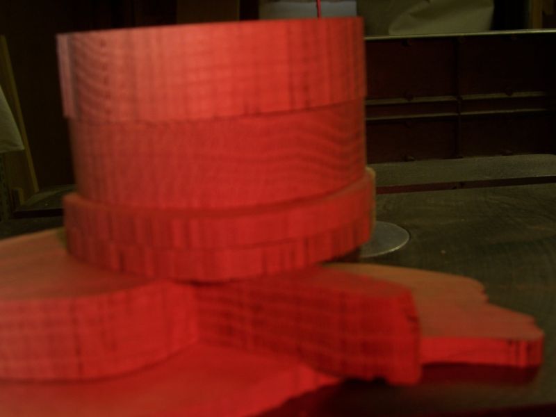

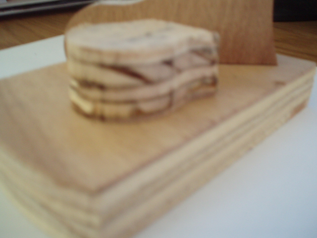

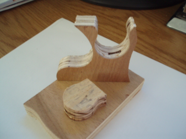

PS to previous post.
I attempted to create some sample cuts of what I thought might be happening to you. These pictures are not very good quality but if they were you would see that the only problems are some burning when trying to cut to tight a turn. There is no gouging. As a point of reference, the piece of plywood is 2 5/8" wide.
One point though. The back edges of this blade had been filed round to aid in tight cuts. I was cutting tight enough circle that the blade was twisting.
Sorry - this might not be your problem. Likely is NOT.
