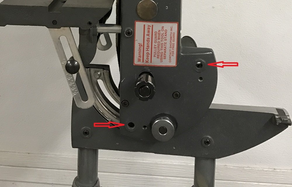

The bolt, washers and nut help hold it in place vertically. You can remove it to use the Belt Sander in horizontal position. Ed mentioned another hole to put the bolt, washers and nut for use horizontally. They are the holes indicated by the arrows below on that 1989 Belt Sander.
_
bolt holes - arrows.jpg (85.08 KiB) Viewed 2682 times
That is the 1989 Belt Sander I restored which, as you can see, does not have the bolt, washers and nut. I don't have them on my Belt Sander I use either. I find the lock set up sufficient when properly adjusted. Not having it also save time when going from vertical to horizontal or vice versa. Use of the extra lock bolt, washers and nut is up to you.

So having all but the 1989 Belt Sander still I looked at them and discovered that the 1998 does have the extra lock bolt, washers and nut. The picture I last posted shows the 1989 having the holes for the extra lock bolt as does my other two Belt Sanders I currently have. Looking at pictures of other Belt Sanders including an early Greenie it appears the Belt Sander has always had the holes for the extra lock bolt. What I find interesting is I have not found mention of using the extra lock bolt in early Owner's Guides. It doesn't show up in the parts diagram or parts list either.
So why have the holes been there all along but no mention of using the extra lock bolt until much later in the Belt Sander's history? Is this one of those unsolved mysteries related to Shopsmith Tools? I am curious so if anyone knows the answer please post it here.
