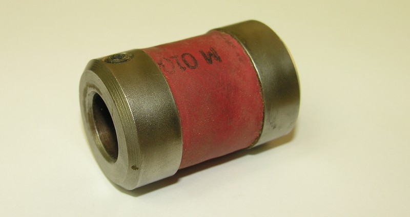

Look up Lovejoy Couplings on Google for info on spider couplers. I have not found much use for them on the SS myself. I do salvage and repair the old 10ER couplers that were used to attach the old 10ER jigsaw. The old coupler was 1 and 13/16 inch in length. Pic is a repaired one using heavy reinforced radiator hose.
ldh
[ATTACH]4551[/ATTACH]

ldh wrote:Look up Lovejoy Couplings on Google for info on spider couplers. I have not found much use for them on the SS myself. I do salvage and repair the old 10ER couplers that were used to attach the old 10ER jigsaw. The old coupler was 1 and 13/16 inch in length. Pic is a repaired one using heavy reinforced radiator hose.
ldh
coupling ID = 5/8" both ends? If so PM me. TIA
