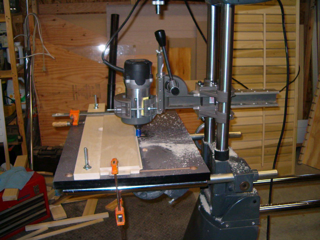

Hi Ivan! Thought I'd be the second person to tell you fences don't have to be parallel to anything in order to route a straight line. In fact, here (at the bottom) is a photo of routing (as you asked) parallel to the bench tubes. I was routing a one inch long dado, 3/4" wide making a slot to accept the control rod for a shutter. I had to clamp the workpiece and also backed it up with a fence. The dado was cut by moving the table toward the way tubes.
Maybe more important is you question/concern about why is routing in one direction so different from routing in the other direction. We have received a good explanation of inside to outside - Good, while outside to inside is BAD!
Although I could always understand climb cut versus plow cut when thinking about edge routing, but was at a loss on how that applied to dadoes and grooves, until I thought of it a bit (no Pun) different.
If we think of groove and dado routing by looking only at the forward edge of the bit as it will pass through the wood. If that edge is rotating toward the fence - that action will hold the wood up against the fence. This will work while routing with an over arm or under table. The difference is, with an overarm grooves should be routed from left to right. Under table, the wood movement should be from right to left.
