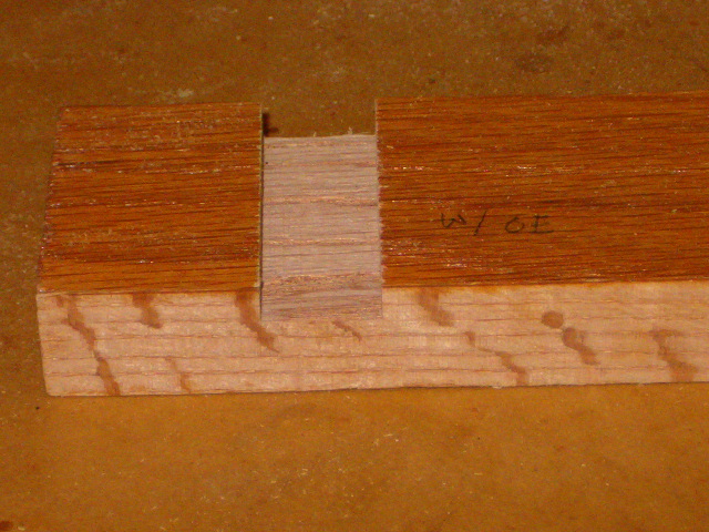

Can't resist this - Photos of dados and grooves using a magna wobble - I also hate round bottoms (in dados that is)
[ATTACH]4609[/ATTACH]
[ATTACH]4610[/ATTACH]
[ATTACH]4611[/ATTACH]
[ATTACH]4612[/ATTACH]
[ATTACH]4606[/ATTACH]
close-up knob.jpg (140.39 KiB) Viewed 5238 times
29_32nds_woble dado.jpg (158.03 KiB) Viewed 5249 times

Chuck, those look every bit as good as the dados I get with my Tenryu set. I replaced an Excalibur wobbler with the Tenryu. My experience with the wobbler was not nearly as positive as yours. Might have been the brand, just not a well made unit, maybe. Bottoms were not flat, tore the edges, and, even though I marked the outside tooth, I was never able to properly align a cut.

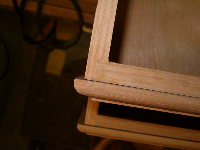

charlese wrote:Can't resist this - Photos of dados and grooves using a magna wobble - I also hate round bottoms (in dados that is)

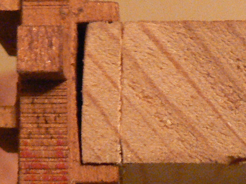

It appears beauty IS in the eye of the BEHOLDER! I am assuming that it was NOT your purpose to display a wobble blade result(S) as 'GOOD". I see the same thing as I dislike. Round bottoms. They are more obvious in the need to fill the box joints in your last pix.
[ATTACH]4616[/ATTACH]
This is not entirely fair. The edge of the insert is not flat either! Put a square piece of paper on your screen, align the lower left corner with the insert corner, and the lower edge with the lower edge of the insert. There is a gap between the paper(square edge) and the rabbet groove bottom. The bottom of the rabbet is deeper at the top than it is at the bottom in the pix. This is the inconsistant depth I also dislike. I have attempted to correct this, but this IS as good as it gets! Do NOT like it! Haven't used it lately. I take multiple passes with a regular blade b4 I would use it!:(

JPG40504 wrote:It appears beauty IS in the eye of the BEHOLDER! I am assuming that it was NOT your purpose to display a wobble blade result(S) as 'GOOD". I see the same thing as I dislike. Round bottoms. They are more obvious in the need to fill the box joints in your last pix.

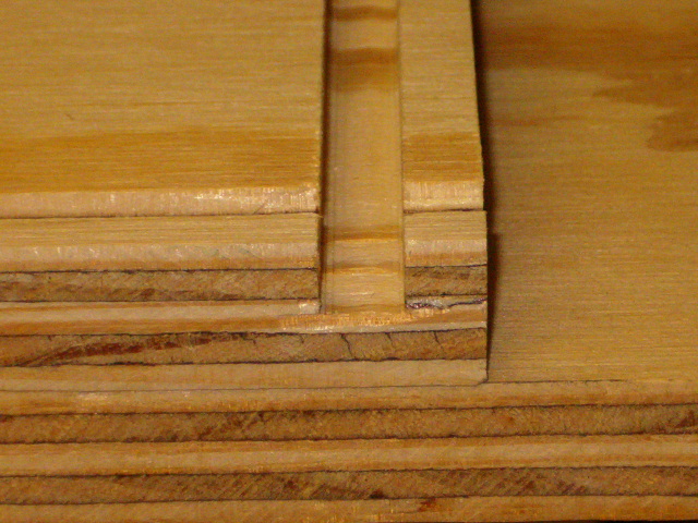

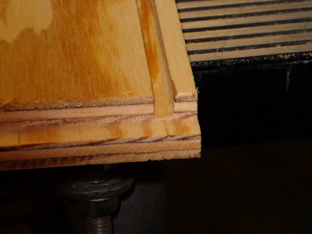

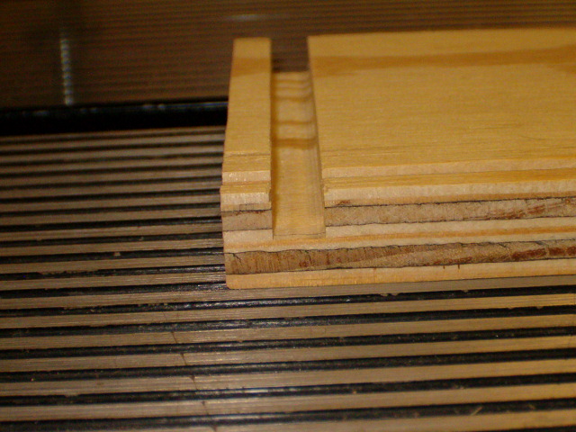

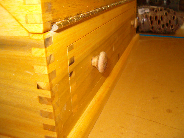

Actually, we are playing a game of he says/ he says! It will get us nowhere, but yes those are flat bottoms. Rounded? Sloped? NO! So here are a couple of photos showing the application of the dados and grooves shown above. They fit pretty darned good, and tight.
The first two photos show fitting plywood. These pix weren't meant to illustrate joinery. You'll have to enlarge them. I can take a close up if you'd like. The third one shows a drawer joint. All joints were made with my wobble.
[ATTACH]4617[/ATTACH]
[ATTACH]4618[/ATTACH]
[ATTACH]4620[/ATTACH]
charlese wrote:Actually, we are playing a game of he says/ he says! It will get us nowhere, but yes those are flat bottoms. Rounded? Sloped? NO! So here are a couple of photos showing the application of the dados and grooves shown above. They fit pretty darned good, and tight.
Those DO look good! Tell us what kind of wobble ARE you using.
JPG40504 wrote:Those DO look good! Tell us what kind of wobble ARE you using.
I bought it from Shopsmith - I think it is a Magna, but there is no brand name on it. Here's a link to what the blade looks like. Carbide teeth and a pretty aggressive cut angle. http://www.amazon.com/Vermont-American- ... 83&sr=8-17

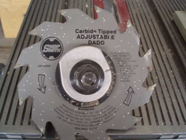

Obviously, not all dadoes are the same.
I too have a Shopsmith adjustable dado blade that I use and like. It doesn't do as good a job as Charlese' but that might not be due to the blade. Charlese is obviously a better craftsman and some of this performance that we are discussing (criticizing) is not due to the equipment.
This is the adjustable dado that I use.
[ATTACH]4621[/ATTACH]

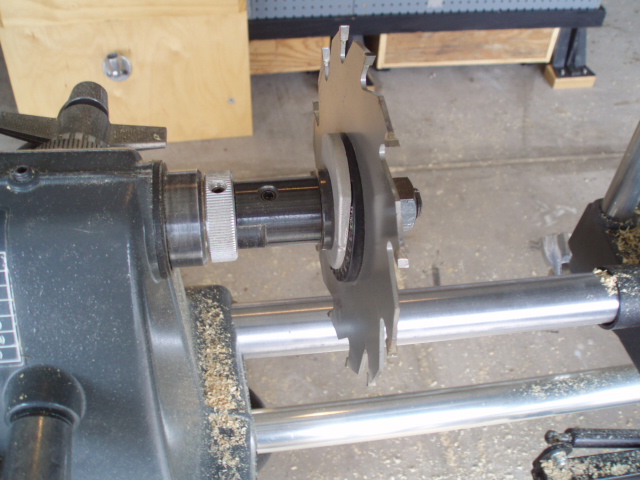

Is this the correct arbor to be used with the dado blade?
[ATTACH]4622[/ATTACH]
