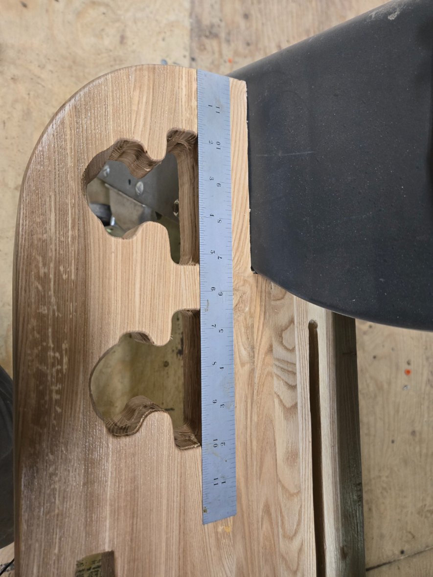

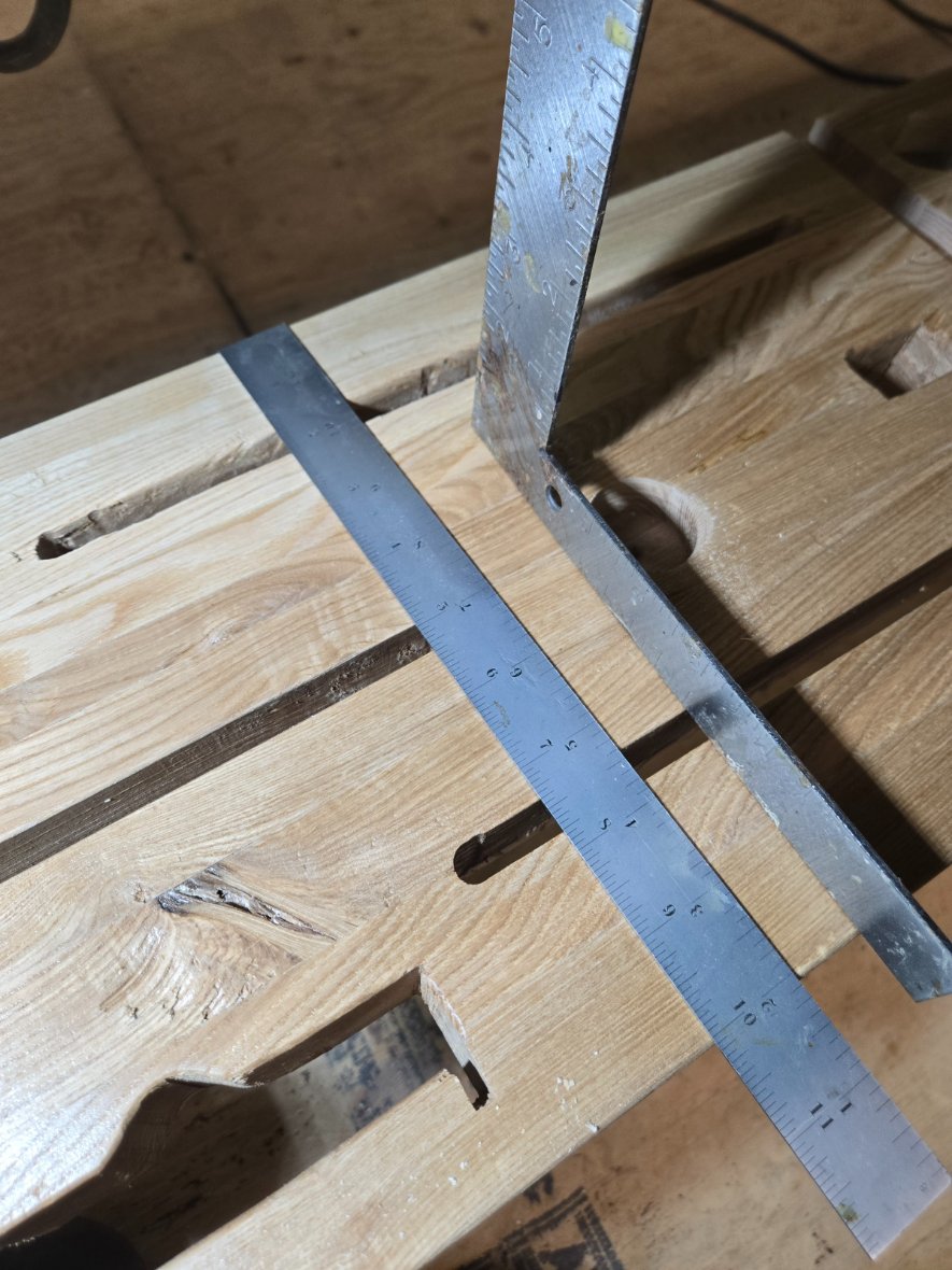

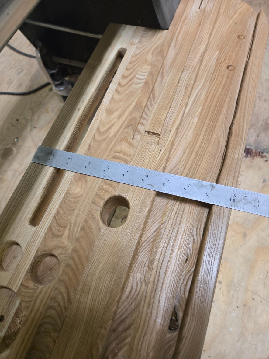

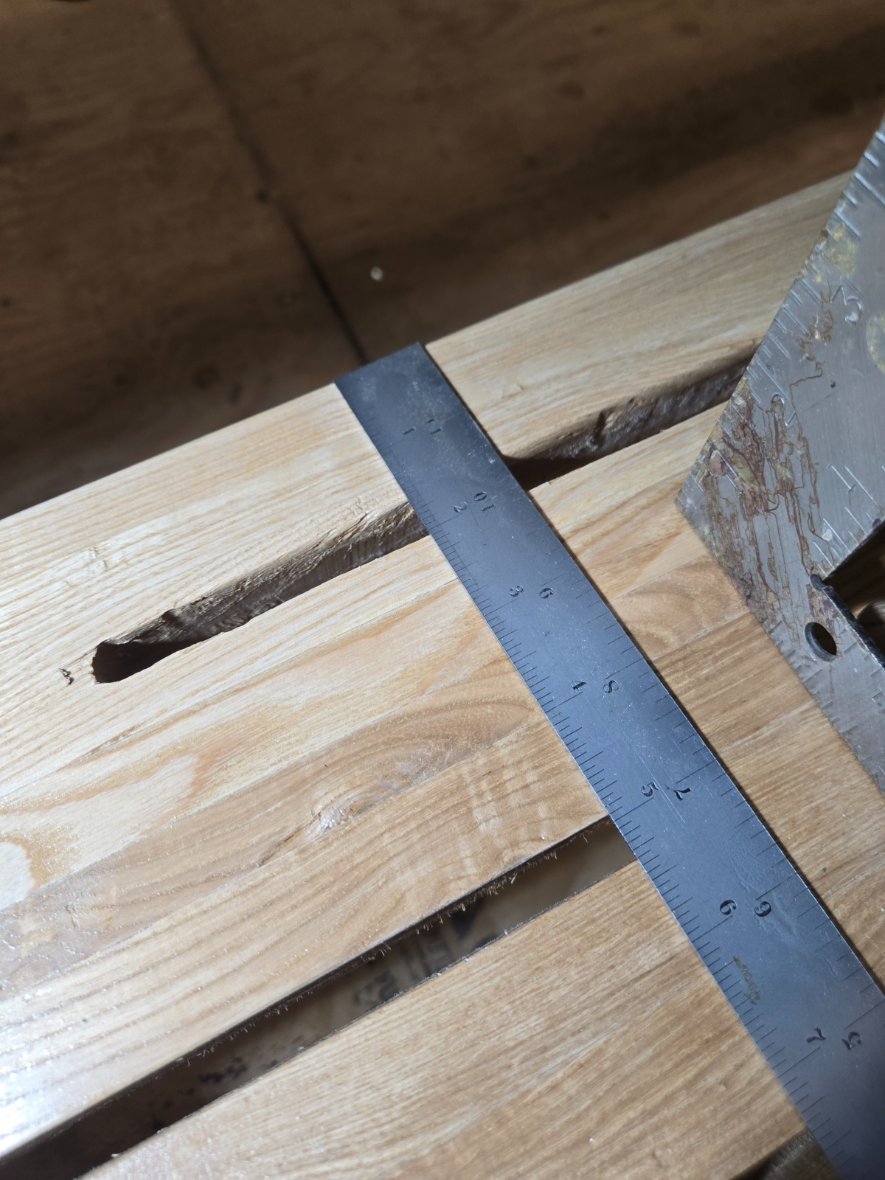

Kevin,
Sorry for the delayedresponse; I am working on a small (6x12) log hauling trailer, and I haven't been in the wood shop or looked at the forum for a couple of weeks. Here are pictures with a ruler for scale. One thing to note is that the back slots for sanding discs are angled towards the operator 10 degrees. I used the overhead routing mode with an extra long 5/16" straight bit to cut the slots. I fine tuned the fit with a rasp.

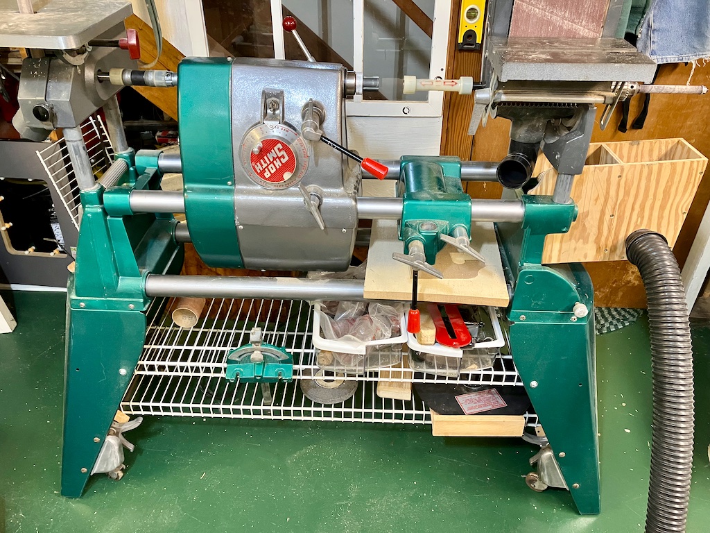

I like to get a peek in peoples shops to see what good ideas I can glee. Here is my 2x12 shelf and wire rack on the shorty. Also the down draft box on the shorty for the drum sander works great no need to go to drill press mode for dust collection.
