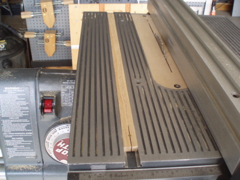

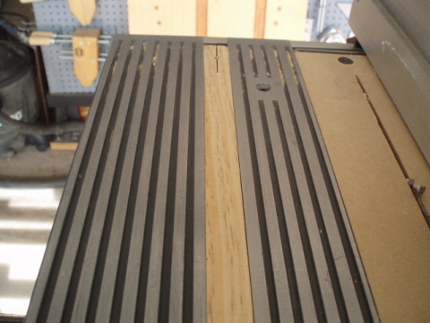

tdubnik wrote:After generally mangling my own zero clearance inserts after using then a few times, I decided to come up with a way to set the blade in the same place every time.
I made a hardwood runner that fit snugly in the left miter slot and then attached a crosspiece that extended past the blade. I then set the table against the headstock bumper and locked it down. Next I extended the quill about 1/8 to 1/4 of an inch and locked it down. Then I cut the crosspiece to length by pushing the miter runner with the cross piece attached through the blade. Now I extended the quill with no table insert and set my zero clearance gauge so that the front teeth of the saw blade would rest against the cross piece when I released the quill. I now tightened the quill and raised the table above the blade.
I now inserted a blank table insert and locked it down. I turned on the Shopsmith and lowered the table to make the zero clearance cut. I then raised the table and removed the new insert. I checked the accuracy of my gauge by moving the table and then moving it back against the headstock. I extended the quill and let it come to rest against my zero clearance jig and locked it down. I reinstalled my new zero clearance insert and lowered the table to make sure it would come down with no interferance. As you can see, I shimmed the end of my jig with a couple of tape strips to get the setting just right. Now, when I install my zero clearance insert and use my zero clearance jig, I get a perfect fit. Since I am referencing from the miter slot and not the relation of the table to the headstock, I have not messed up another insert yet.

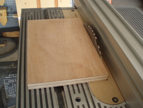

I have been challenged by this thread and I am going to run with some thoughts brought about by the conversations here.
I sorta built one of these for my own use and while doing so got side tracked onto a project to build a new "Auxiliary Table" for use with the Sliding Crosscut Sled.
My thought now is do build the Auxiliary Table so that it fits right up against the left side of the blade. By doing this the Auxiliary Fence doubles as "the gauge" while serving its purpose along with the cross cut table.

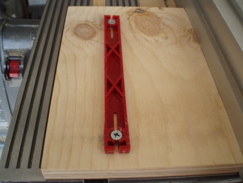

First task was to develop a miter bar to be used for this sled and the gauge.
I had a plastic Shopsmith bar for the gauge but needed to cut one for the sled. I had no hardwood suited for this task but was pressed (by myself) to do with what I had. I cut a piece from another gauge I had in the shop (I think it might be poplar).
The bar was just a little bit sloppy so I devised a way to expand it. Devised is not the right word. I copied the method employed by Shopsmith on the plastic bar from a finger board using a small brass screw in a bandsaw kerf. Photos attached.
