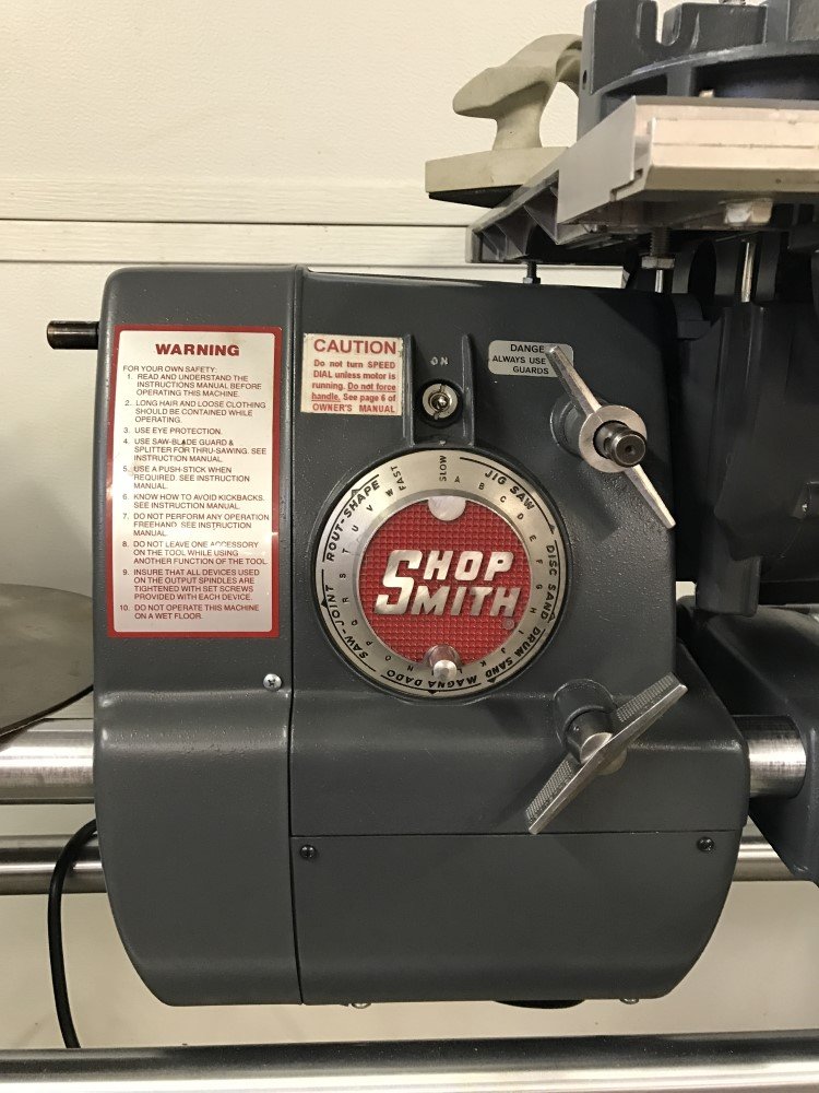

StoneyD,
There is more than one possible cause for your incorrect speeds.
The simplest might be the Speed Control Dial being out of position. When turned down to the slowest speed with the Speed Control Handle does it go past the slow position towards fast? If so, the Speed Control Dial needs to be repositioned. With the Speed Control Assembly correctly adjusted the speed at slow should ideally be 700 RPM.
Another cause for incorrect speeds would be a worn or mis-sized V Belt between the Motor and the Idler Shaft Assembly.
Excessive "drag" in the system due to worn Bearings could slow the speed down. Not likely in your case since your speed runs high.
Other speed inaccuracies could be caused by the Motor itself. Something that causes the Motor not to run at its rated speed of 3450 RPM. You could use your tachometer to check the actual Motor RPM. That would be another easy thing to check.
The Speed Control Dial should stop at SLOW as shown on the Headstock below.
_
March 1982 Headstock.jpg (129.44 KiB) Viewed 16779 times
