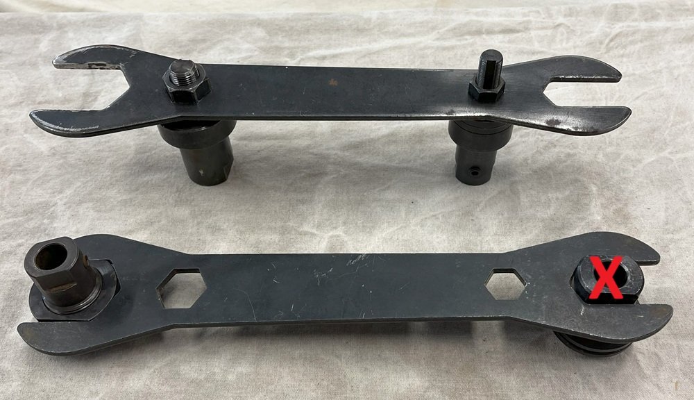

Dusty's post had me go out to the shop this morning to take the following picture I had been thinking about doing for this thread.
The top Wrench has the 5/8" Arbor 505506 on the left and the 1/2" Arbor 505505 on the right. The lower Wrench has a 1-1/4" Arbor on the left on the nut and a 5/8" Arbor on the right actually on the base but is also the same size used for the nut on that size Arbor.
EDIT: Correction the base uses a smaller 7/8" Wrench than the Arbor Wrench at 15/16" so the arbor shown in the bottom right of the picture should be using it on the nut. Disregard what is shown under the X.

jimbeaux,
Good question and I don't have an exact answer. We could make guesses. The 1-1/4" Arbor Hole Saw Blade & Arbor on the Mark 5 when it was introduced in 1954 and was a 9" diameter Blade. There are blades made by other manufacturers that have a 1-1/4" Arbor hole.

chapmanruss wrote: Thu Aug 21, 2025 5:49 pm Dusty's post had me go out to the shop this morning to take the following picture I had been thinking about doing for this thread.
_
jimbeaux,
