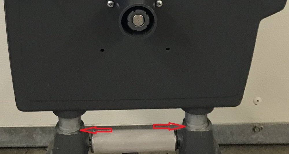

If you use the offset tubes, can you simply push the head stock left to engage it and push right to use the other features?
Yes.
As for any of the SPT's (Bandsaw, Belt Sanders, Jointer, etc.) powered by the Headstock Hubs on the left side you engage them for power by sliding the Headstock to the left with a Power Coupler between the Headstock and the SPT. Sliding the Headstock to the right disengages the Power Coupler. When installing the Eccentric Mounting Posts set them so the offset has the SPT farthest from the Headstock as shown in the picture below. This gives you the most clearance possible for raising into Drill Press mode with a SPT mounted. Some have commented that the Offset Eccentric Mounting Tubes I showed in my last post do not hold the Bandsaw as stable as the regular Eccentric Mounting Posts.

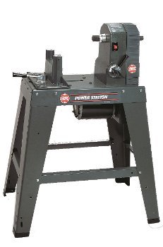

An option for the Bandsaw or any SPT would be to have it on its own stand. You can build your own, buy a Shopsmith Power Stand or a Shopsmith Power Station. The Power Station was discontinued so that option would be to find a used one. The Power Stand holds an STP and uses pulleys of different sizes to set the speed to power a single SPT. The Power Station has a variable speed Headstock and makes it easy to change between different SPT's. I like the Power Station for my SPT's and have 2. My Scroll Saw on one all the time unless needed for a different SPT.

Below is a Power Station.

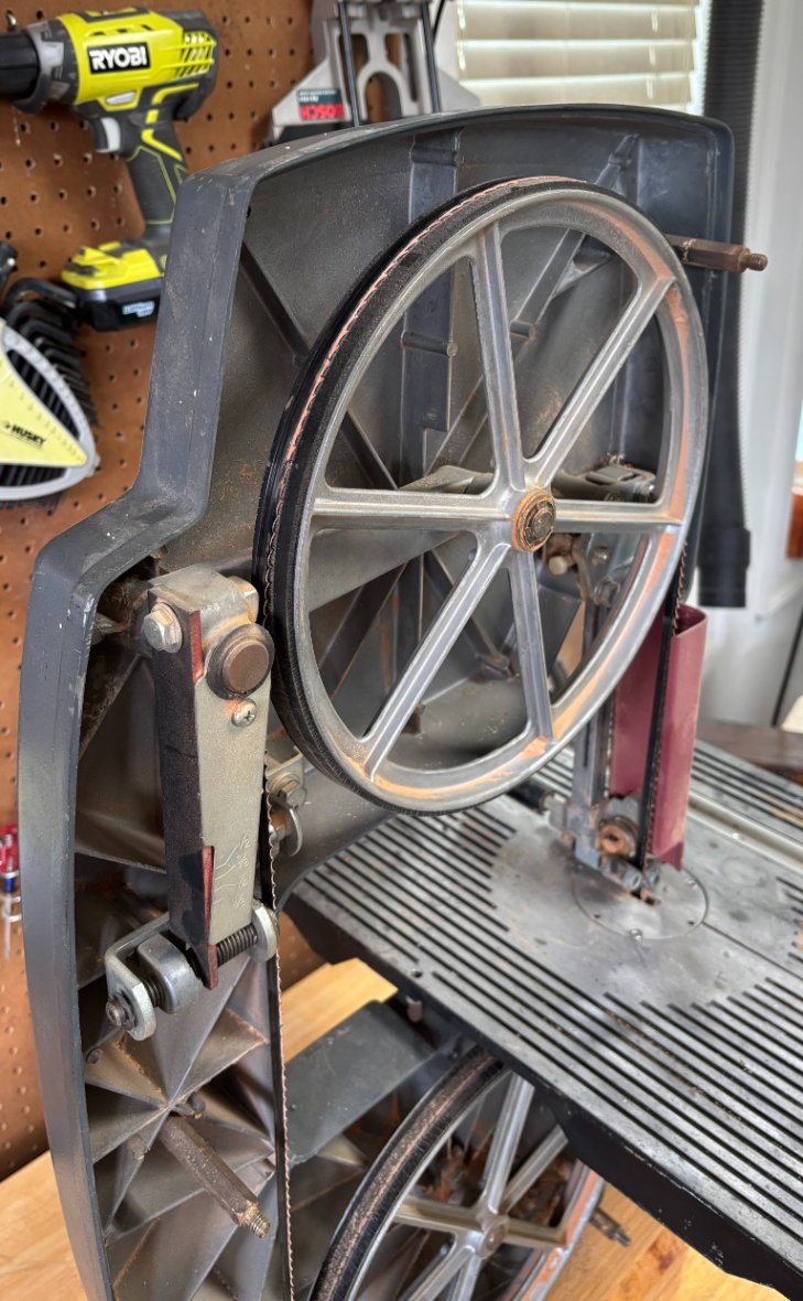

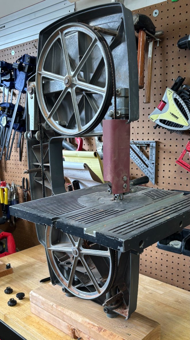

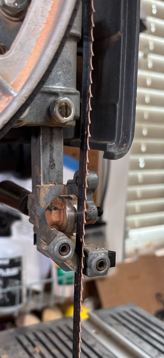

Hi guys. I found a used bandsaw finally for $200. Looks like a Mark V model but I leave that to you experts. I would say it is in fair condition but I have been looking for 6 months in my area with limited success. The tires are cracked. I have not taken it apart yet to spin the bearings. The tension mechanism looks good. The wheels look true and not bent, when I spin them by hand. It came with a single blade, looks like 3-4 TPI ½”.
What would you suggest I replace to make it hum again? My plan was to scrub the table, replace the tires with urethane tires, replace the bearings with new SS ones, and replace the guide blocks with Olson cool blocks. Does anyone agree or disagree? I saw SS sells an overhaul kit with all the above plus wheels but I don't understand why I would need to do that if the wheels are true and spinning fine. I would prefer to sink $75 and not $250 into it unless necessary.
Many thanks,
Karl

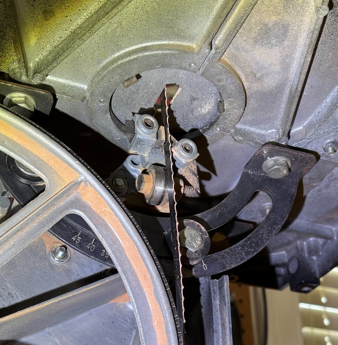

Another few pics

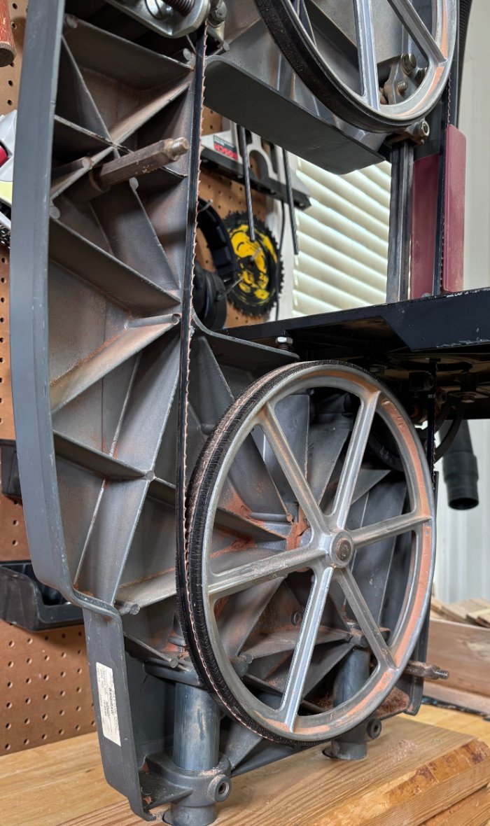

Last pic

A clean up is a good place to start. If the wheels are true and the bearings are good there isn't a need to replace them. The upper wheel bearing likely needs to be greased. It is not a sealed bearing like the lower wheel. Do the greasing as you put the upper wheel back on after removing the bad tires. Removing the cracked tires is more easily done, in my opinion, with the wheels out of the Main Frame casting.
Your Bandsaw already has the sealed bearings for the auto track and upper & lower Guides. They probably do not need replacing.
I use the Olsen Cool Blocks on my Bandsaws and prefer them to the original metal Blocks.
There has been a lot of debate over which urethane tires to use. Most seem to prefer the blue ones sold by Bandsaw Tire Warehouse over the orange ones sold by Shopsmith. There have been complaints of the orange tires coming off during use. My Bandsaws have the original type rubber glue on tires even for ones I have replaced. I did put the blue urethane tires on one Bandsaw I restored and haven't had any complaints from the buyer.
For $200 it looks like you got a nice Bandsaw.

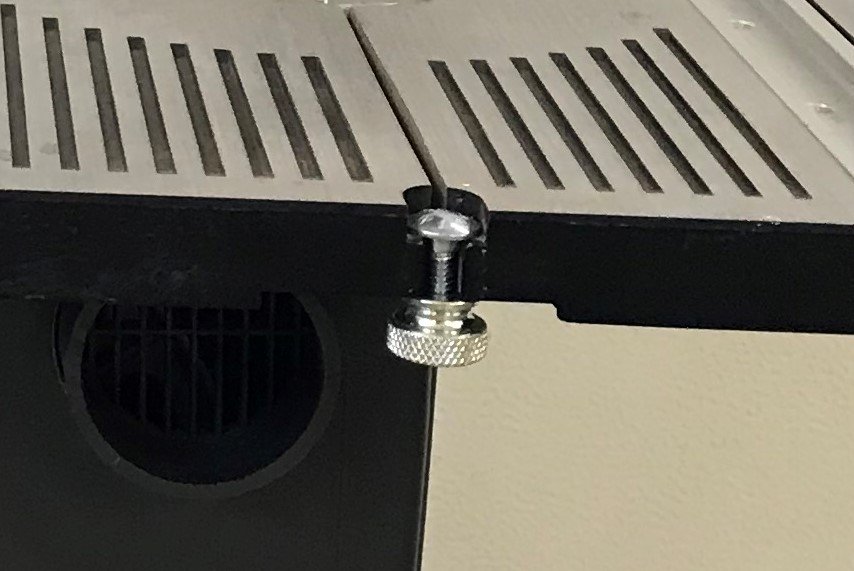

Something I noticed in the pictures is the Carriage Blot and Knurled Nut are missing that keeps the opening level on the Table as seen below.

Many thanks Russ. I will take your advice on the overhaul and also replace the missing knurled knob from the table.

The carriage bolt and knurled knob are fairly common hardware parts and I have found them at my local Ace store when I needed to replace a missing set.

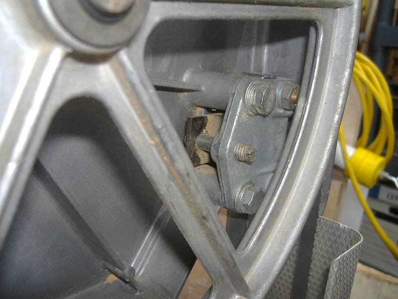

One of the biggest challenges when reassembling the Bandsaw after restorations is adjusting the Upper Guide Assembly. It needs to be adjusted so that the Guide Column stays in line with the Blade as it is raised and lowered keeping the Upper Guide bearing from barely not touching the Blade. This is done by adjusting the screws in the Guide Column Bracket to keep the column in line front to back when looking at the teeth side of the Blade. The Guide Column Bracket also sets the tension of the lock to hold the Upper Guide at the proper height for the material being cut. Generally, 1/4" to 1/2" above the material being cut.

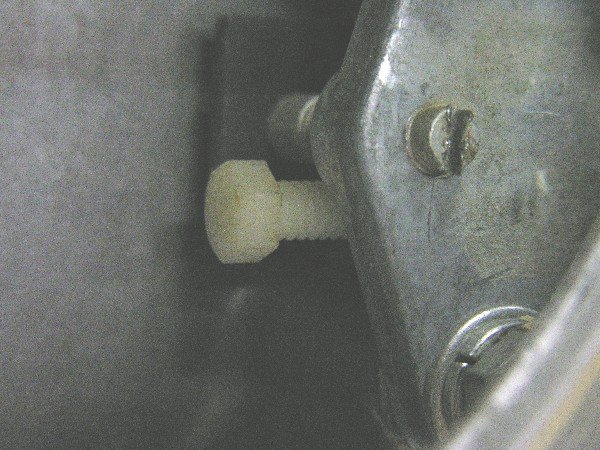

Newer Bandsaws have a nylon Bolt in the Guide Column Bracket to better keep it aligned side to side. The first picture below shows the Guide Column Bracket with the nylon bolt. The second picture shows an earlier Guide Column Bracket without the nylon bolt. For Bandsaws that do not have the nylon bolt in the Guide Column Bracket it can easily be added. I do recommend this addition for early Bandsaws without the nylon bolt already.

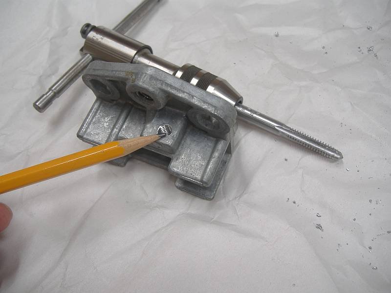

Adding the nylon bolt requires drilling a hole in the bracket in the location shown below and tapping threads for the bolt. Use a 1/4" x 20 x 1-1/2" nylon bolt. These can be found at some hardware stores that have a larger selection of nuts. bolts, screws, etc. Shopsmith sells the Bandsaw Upper Guide Nylon Guide Bolt SKU: 517908 for $6.95 and shows it currently available. Drill and tap for the size of the bolt you get. It can be one size smaller or larger than 1/4".
