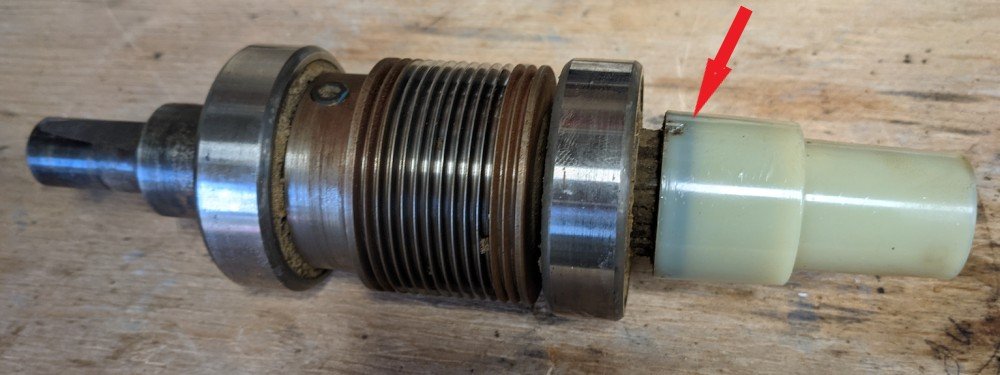

Have changed the quill bearings and it's not them. Getting a 0.012"-0.014" runout on the spindle. Will look at the drive assembly next.
Posts: 4533
Re: Wobble on headstock with scroll chuck
Check the Drive and Ring attached to the Drive Sleeve Assembly first. It is the nylon part shown on the Drive Sleeve Assembly in the picture below. The arrow points to the location of the ring in the drive. It is a round ring that keeps the drive on the Drive Sleeve Assembly. If the splines in the drive are worn it can contribute to runout. There are no splines in the metal sleeve of the Drive Sleeve Assembly itself.

Stripped everything down today and there is a good bit of movement between the drive and ring and the spindle. Have ordered a new drive and ring to see if that might improve things. Waiting to hear back from UK parts supplier on how much runout there is on a used quill assembly he has. Thanks for all the help so far!
