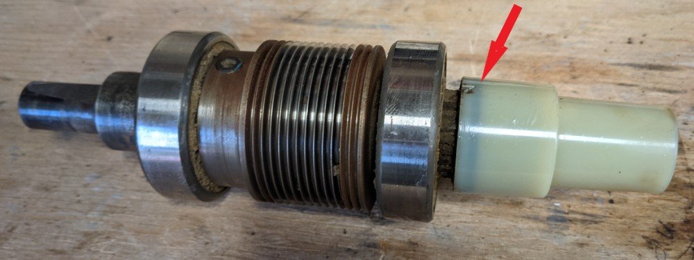

Have changed the quill bearings and it's not them. Getting a 0.012"-0.014" runout on the spindle. Will look at the drive assembly next.

Check the Drive and Ring attached to the Drive Sleeve Assembly first. It is the nylon part shown on the Drive Sleeve Assembly in the picture below. The arrow points to the location of the ring in the drive. It is a round ring that keeps the drive on the Drive Sleeve Assembly. If the splines in the drive are worn it can contribute to runout. There are no splines in the metal sleeve of the Drive Sleeve Assembly itself.

Stripped everything down today and there is a good bit of movement between the drive and ring and the spindle. Have ordered a new drive and ring to see if that might improve things. Waiting to hear back from UK parts supplier on how much runout there is on a used quill assembly he has. Thanks for all the help so far!

For clarity, do you have a Poly-V Drive, as opposed to a Gilmer? And a single bearing quill as opposed to a two bearing quill? I think it's important to be clear about the versions because the failure mechanisms vary quite a bit. For example, a two bearing quill is much less dependent upon Drive and Ring condition than a single bearing for minimizing runout. And it has been reported that a bent spindle, sometimes caused by a 'catch' during turning, is more common in two bearing quills than single bearing quills.
I expect a two bearing quill to exhibit <0.002" of runout, though I haven't seen this specified anywhere. I don't have good numbers for Gilmer drives (which are metal to metal and don't have the replaceable Drive and Ring) or Poly-V with single bearing quills.
