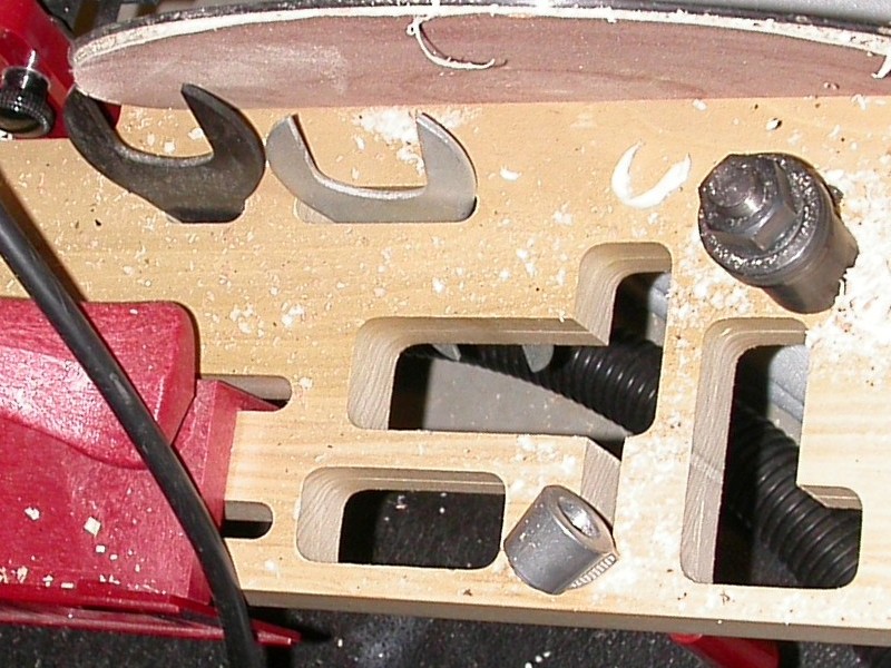

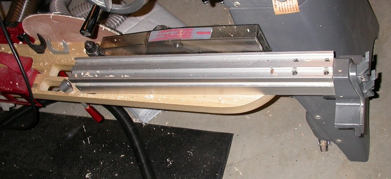

Tool Shelf
OK, now I'm really confused.
Long ago, I purchased a 510 and later added a tool shelf to it. I have been using it for all of these years. A few months ago, I bought the 520 upgrade kit and I still store the same accessories on the shelf that I did in the beginning.
I do not put the rip fence there. Never have.
How is this new tool shelf different? Pictures would really tell the story.

dustywoodworker wrote:OK, now I'm really confused.
I sold the old one a long time ago, I think Shopsmith has been selling the newer shelf for many years.
Notice that the rip fence fits and the newer safety devices also fit. I am not sure what the other changes are.
[ATTACH]116[/ATTACH]
[ATTACH]117[/ATTACH]
Tool Shelf
Thank You. This is different than mine. Quite a bit. I do not have the "L" shaped or the "T" shaped holes and my fence straddler is offset 90 degrees from yours.
Maybe a little router work will produce an upgrade. I think I can see router tracks in your photos, two plunges. I have to wait until daylight though. Lights went out in the shop last night. Glad I wasn't in the middle of a saw cut.
