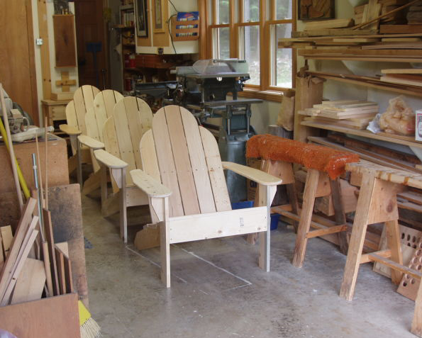

I have built 6 Ad. chairs with my SS over the years. All have been made of inexpensive "white wood" right off the racks at local big box stores, then painted with decent exterior paint. The paint is renewed about every other year of so. This gives my live-in interior designer the chance to change the color of the chairs:D Common wood screws and waterproof glue hold everything together. Waterproof putty plugs the countersunk screw holes. The first couple of chairs lasted nearly 15 years, and were left out in the weather year-round. Water finally got into the plugged screw holes and also into the end grain of the legs, and started the decay process. The problem of water intruding into the end grain of the legs probably would have started sooner if the chairs had spent their summers on a lawn instead of a patio. The current chairs are located on a wooden deck and stored in a shed each winter, so they should last even longer.
What have I learned from the chairs built so far? Well...1) Next time I would choose a design that has a well-rounded edge on the front edge of the seat...easier on the back of the knees than an angled edge 2) I would not hesitate to use the same materials for most of the chair...the "character" of an Adirondack chair is its lack of pretension. Common materials and paint finish suit it best, in my opinion. However, one change I would make would be to use weather resistant wood for the legs, the one part of the chair that comes in direct and prolonged contact with moisture. I am thinking that cedar legs should hold up pretty well. Or, this might be a place for your pt wood.
Good luck with your project...and enjoy your chairs!

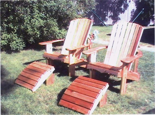

Yes, i made some beautiful chairs out of select heart redwood.
Unfortunately, my yellow lab chewed them to oblivion!!
