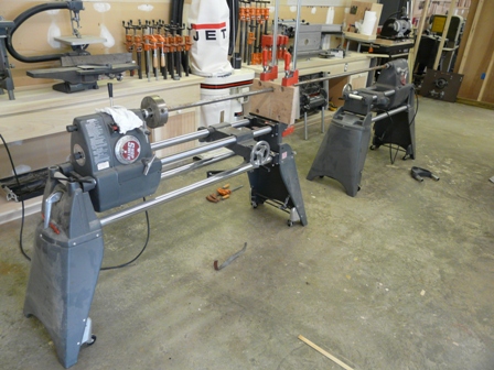

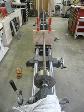

EMT is slightly under 1". I think it is the 3/4 EMT but measures about 15/16. As it turns out garage door pipe was mentioned earlier in the thread and I have 2 20 foot lengths at my brothers house. He is going to cut me 2 8' sections from the cleanest areas and deliver the next time he comes my way. It is exactly 1 inch and heaver than EMT. I may have to send it to MickyD to remove some rust.;) :)

Gee Dear that looks a little dangerous!
Post by mbcabinetmaker »
That is the comment my Wife had for this set up. My reply was (Not at all, I saw MikeyD do this and he only used one Shopsmith. This is going to be twice as safe.):D :D ******************* I don't think she bought it but she left to run her errands and left me with my fate in my on hands.
[ATTACH]5497[/ATTACH]
[ATTACH]5498[/ATTACH]
These are the 8' sections of garage door rod. The slight surface rust was quickly cleaned up. Sorry the after pictures did not come out so well.
