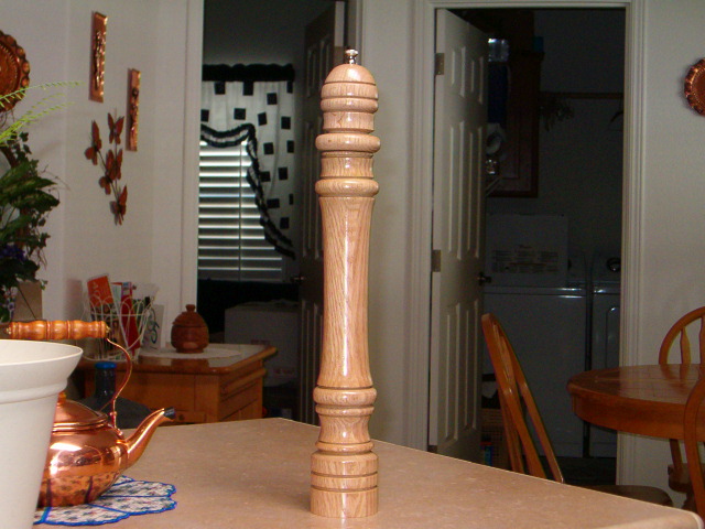

charlese wrote:Hi Tango! I have made several pepper/salt mills. The longest was an 18" mill.
This one was made from red oak. I found I had to drill from each end to keep the holes, at the ends, to be perfectly centered.
Charlese;

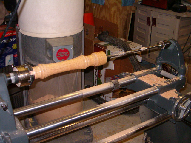

There was a offset of about 1/16". I worked the bit in past the offset several times from both ends. That took made a chamfer in the ledge. Then some sandpaper on a dowel. Daughter reports no problem in hanging up pepper seeds.
The attached photo shows a disaster in the making. There are two 6" extenders on the end of the bit. To make this disaster, I drilled all the way through. The hole at the top was 3/16" off center. Of course, the top would rotate like a cam. (bad news).
If I would have planned better, I would have stopped the bit about 1/2" from the top. Then I could have drilled a centered top hole and easily have carved down (tapered) the offset. Instead, I turned a new body and used the already prepared top.
The off center one turned into a flower vase. Maybe some day it will be a lamp.

P.S. Charlese, that's a great pice of work you have there! It makes me want to try making one!

charlese wrote:There was a offset of about 1/16". I worked the bit in past the offset several times from both ends. That took made a chamfer in the ledge. Then some sandpaper on a dowel. Daughter reports no problem in hanging up pepper seeds.

With the hole bored out from one end I'm hoping that everything will line up better. This new setup of mine should alleviate a lot of the problems I've been having, but I'm sure some new ones will pop up before too long.
