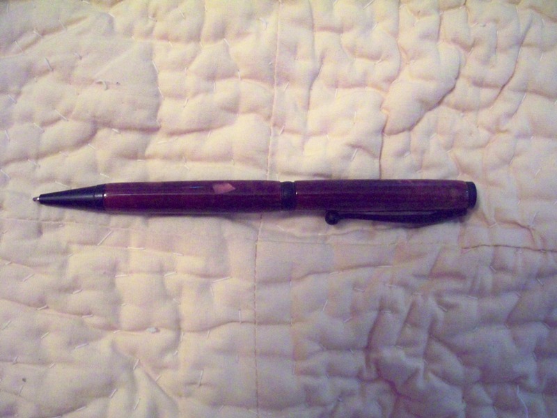

The live center in post 8 is my SS live center which SS sells. I have had no problems using it on any turnings I have done. The instructor at a couple of TA's I attended used this version to do both spindle and pen turnings as well. The live center that is described in post 12 is better from what some folks say but I can not comment on it myself since I don't have that one. The difference between the dead center & live center is like someone mentioned, one does not move and you probably need to put bees wax on it to create less friction while the live center pointed portion moves thereby causing no friction while turning and two TA instructors both affyx - I only have one pen around that I could take a picture of so here it is. This pen is made from acrylic using the wet sanding method. It is a crimson red in color and a slimline pen. I have done both wood and acrylic but usually make them for gifts or sale if someone wants to pay for one. For what you have to charge for them in order to make any profit, most folks don't want to pay that much for a pen. There are however some folks out there that appreciate handcrafted items and are willing to pay what you ask. [ATTACH]5515[/ATTACH]

Ron, just having plan nosiness here. HOW much do you ask for?
Probably not enough as between the blank and the pen components plus a small clear plastic case I had about $10 invested and only sold them for $15.00. Should probably have asked at least $20. I haven't really tried to get anything going as far as making extra money from what I consider a hobby, but its something I may consider. I gave more away as gifts as well as turned Christmas ornaments and a few captive ring baby rattles. When I sell a baby rattle I ask $25 for them. My avatar is an example of the baby rattle.
