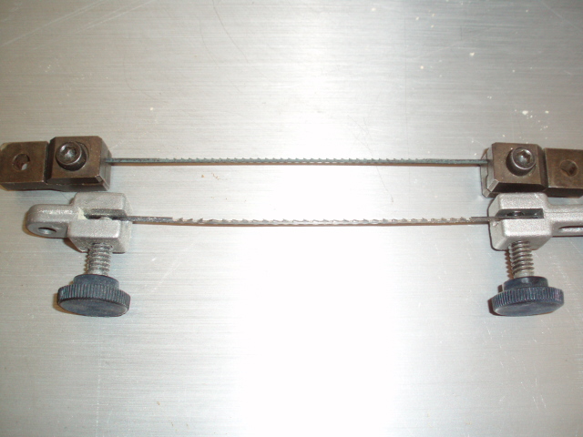

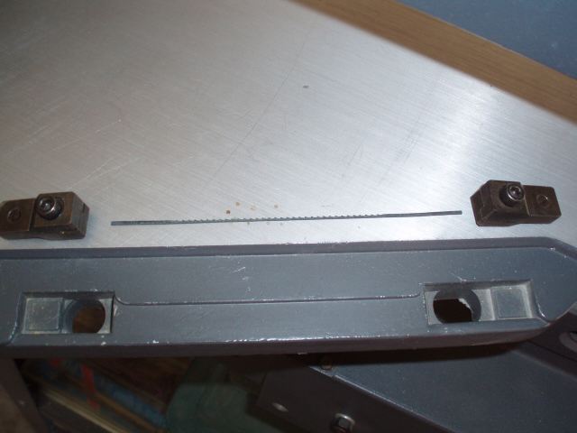

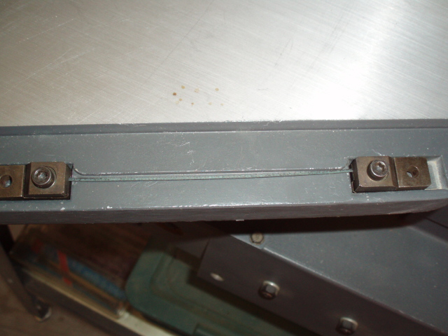

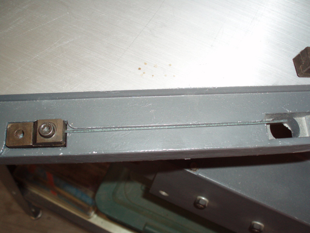

I decided to pursue the noise and at the same time compare the previous blade mounting method with the new improved method. I was actually thinking that maybe the length of the assembly was contributing to the noise issue.
Sure enough, the two are not the same in overall length. The pictures tell that story. Using the new (modified) fixturing, the overall length is "shorter".
When I put the old fixture and a blade in the scroll saw, tensioning was way off. Adjusted that and I had a smooth running scroll saw. No knocka, knocka. Hmmmm.
Put the other assembly (new fixture and a different blade) back in the scroll saw. Naturally, tension was again way off. Readjusted tension and turned that puppy on. Guess what. No knocka, knocka.
Got me!
Got me!
