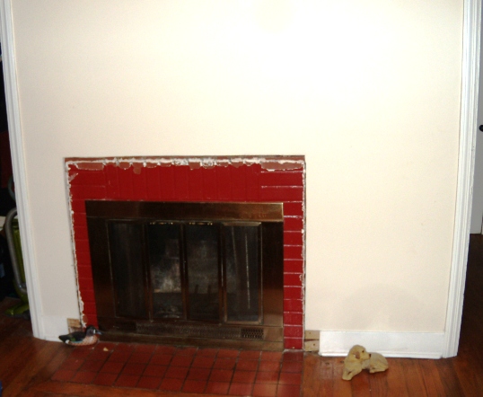

Thanks, I will check with the code dept. I like the ones you all have done. We just redid this wall, I still have to take the old paint of the brick. I may tile over it. As you can see the fireplace is not centered. It would be easier if it was. I think I want to go from door to door. Building a inset for the fire place tools on the right. Old house. Nothing is square! I will post as I go.
[ATTACH]7291[/ATTACH]
