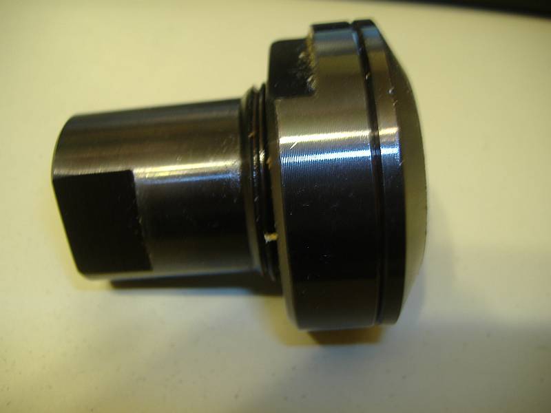

Don't know if I have any new ideas but I just took a few pictures. This is the arbor I have for my 520.
This picture show the arbor closed with no blade mounted, this should be about what you would see with any of these arbors.

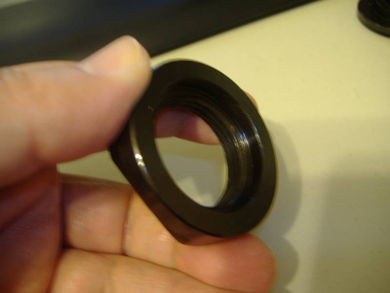

The arbor with nut off show the area where the blade mounts, the hub has a step that fits the saw blade size.

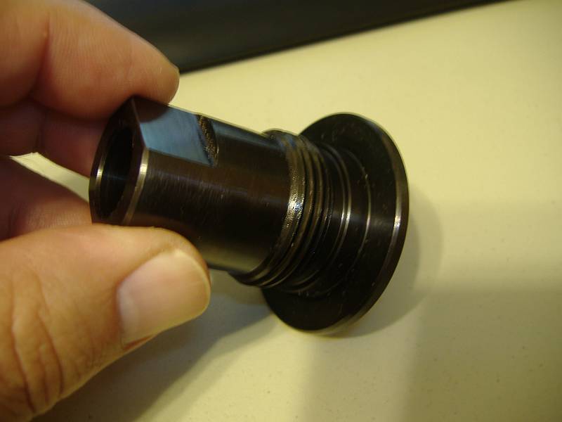

This photo is the nut, the side facing us is the side that would go against the blade.

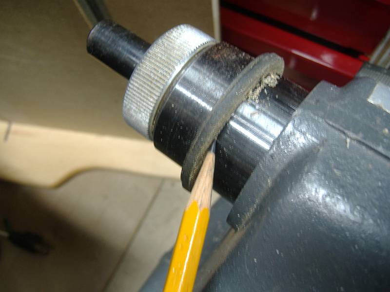

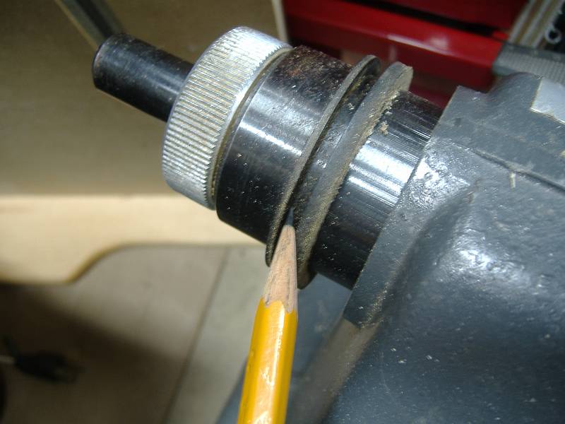

The spacer they mention is shown in the next two photos. First as it might appear on the quill, and the second one with it moved out so you can see it better. This spacer has nothing to do with the mounting of the blade or arbor. It is simply a spacer for dealing with lower blade guards.

I have heard of having a screw loose, but, a missing Nut????(with a left hand thread no less!).mickyd wrote:Anyone one know if ShopSmith also sells just the nut? If so, part number?
Call 800-543-7586 You might get lucky! Call Early - 3 hours earlier!
P.S. Maybe you could find one at someplace where they sell bolts and nuts!:D

Yes they do, and the sooner you call the better as this could be a problem with just yours or it could be a whole batch of bad ones... so the sooner they know about it the sooner they can determine that. A batch problem might then say they have no stock to replace yours for now, but the sooner they get at the issue the better it will be for all of us. Let's hope it is an isolated one of problem, and you can get a correct one and start making saw dust.
bi0nd0smith wrote:thanks for the pic - I see that something is probably wrong with my arbor -
does anyone know if shopsmith takes returns?
