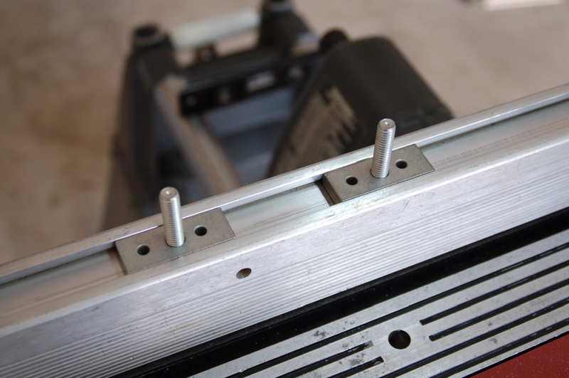

Resolved!
Greetings,
After closer inspection, I observed that the "head" of the bolt on the bottom portion of the t-nut was to blame. It was worse on one t-nut than the other. I filed it down, cleaned both the fence and t-nuts and all are sliding now
I am still awaiting a call back response from Shopsmith. Hope this helps someone else who runs into this problem.
Dan
Dan

There is more than one t-nut. The differences are obvious when one knows what to look for.
The ones that I have are #555916 and they do not come with the stud shown in your photos. Instead, there are three threaded holes to accept whatever you might want to install into them (knobs, setscrews, etc.)
The ones that I believe you have are #514491. I can't tell from your photos but it appears the studs are part of the t-nut. I conclude from the photos that the t-nut fit the t-slot. The protruding stud (head) was the cause of your problem. The studs may not be part of the t-nut but rather used with the t-nuts.
Once again it is shown that in order to draw accurate conclusions you must have "the facts, all the facts and just the facts". I think Sergeant Friday said that first.

The two types of t-nuts are NOT identical. The physical dimensions are the same (length, width, thickness) but the center hole on 514491 is counterbored on the under surface). The counterbore is very shallow; only about 1/32" deep. Not even (IMO) deep enough to facilitate the thinkness of a flat head on a bolt.
Both part numbers are the same width, 7/8" (not 29/32").
These (514491) were purchased without the last few weeks.
