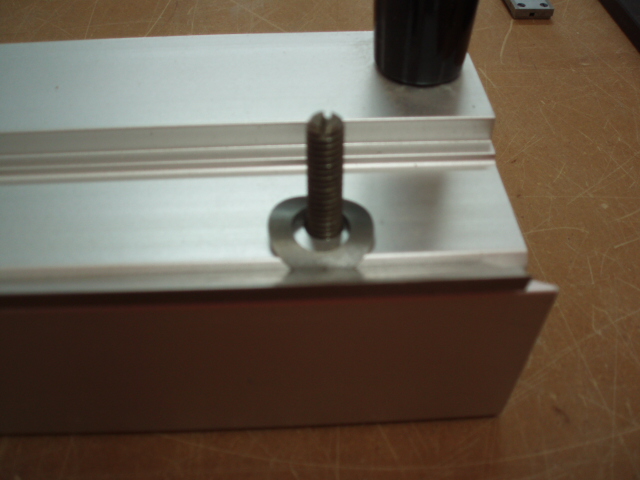

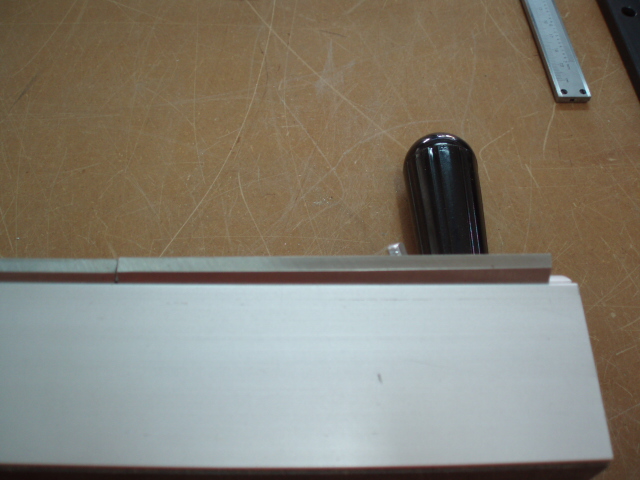

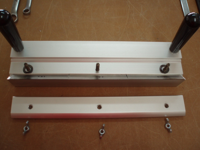

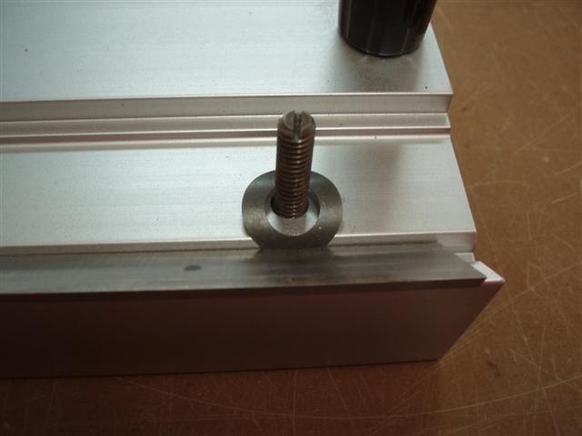

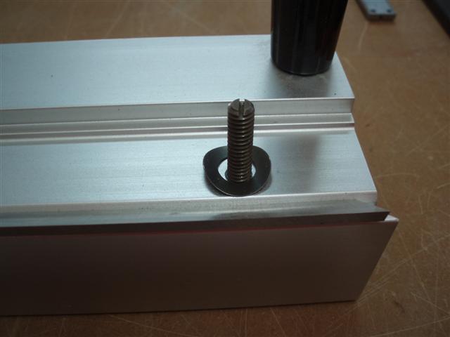

I disaassembled and reassembled the Sharpening Jig a couple times looking for ways that could easily cause problems that might not be readily detected. It certainly can be done.
I present some images that I think show how a blade set could very easily be destroyed (along with a couple good shots).
Proper Layout.JPG (129.59 KiB) Viewed 5322 times
Spring Washer and Blade.JPG (32.39 KiB) Viewed 5319 times
Trouble in the Making.JPG (33.5 KiB) Viewed 5323 times
Blade with Washer Misplaced.JPG (131.54 KiB) Viewed 5321 times
Assembled Incorrectly.JPG (143.44 KiB) Viewed 5324 times
