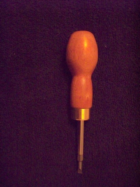

Well, I finally got some screwdrivers made from the material my son-in-law gave me. It was mahogany after all. He really liked the screwdriver (Christmas gift)
[ATTACH]7097[/ATTACH]
Jason Screwdriver.JPG (91.24 KiB) Viewed 2837 times
