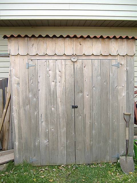

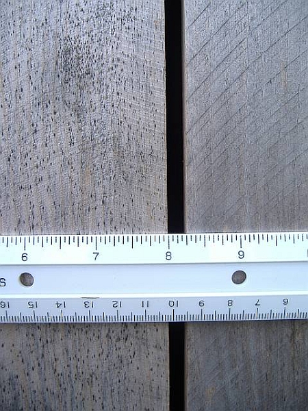

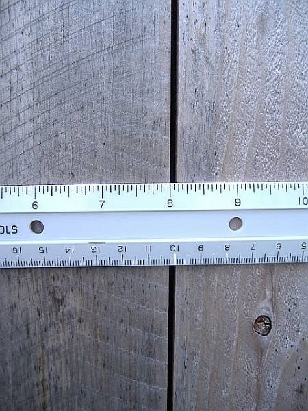

In some cases you just work with what you have and damp wood is sometimes what you get. In this case I was building a garden tool storage area and while the wood was far from dry it really didn't make much difference in this case. In fact, the fact it was wet and was going to shrink later was one way to make sure the project would work out.
In this case I built using the wet wood and having it butted tight together knowing that as it dried to a more normal level I would end up with some air flow, and this is what I wanted.
The first picture is a front view so you get the idea of what I was building. The second one is of the gap in the door. when I do a project like this I always go for an overlap and then hand plane the doors to fit and this is what I did this time too. As you can see, today the gap was about 1/4". The walls are somewhere in the 3/32" range... (again this depends on the level of moisture in the air) that can be seen in the third picture.

Nice technique and results on your cedar shed. That's one of the most straightforward proofs of dimensional changes I've seen, too.

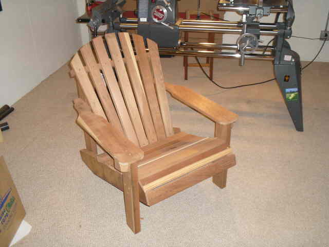

Well,
I had gone without a jointer most of the year. But the Jointer Setting video had, attached to it, a real deal on new Jointers. I got one!
As a result, here is my chair I've been working on every now and then, totally from salvaged "trash" lumber, the past 6 weeks or so.
By the way, EVERYBODY is posting great projects lately. I would dominate the message boards if I complimented all of them....
