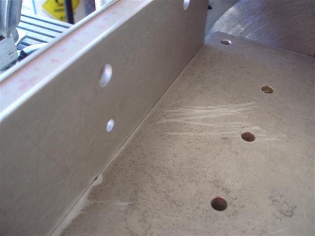

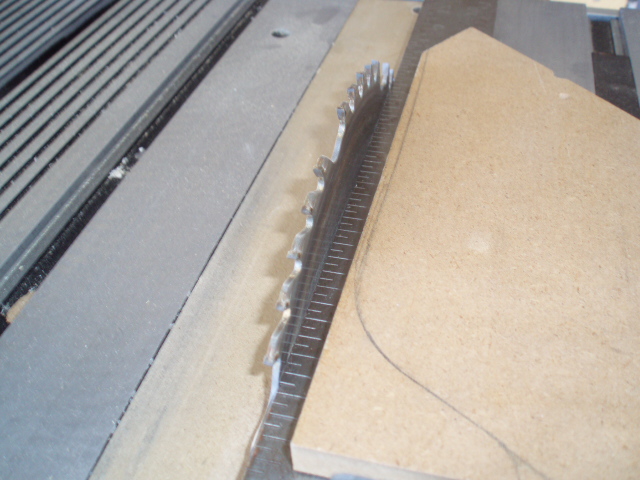

[ATTACH]6955[/ATTACH] [ATTACH]6956[/ATTACH]
See that "Tiny Gap" - .002" - "definitely close enough for wood working"

dusty wrote:I guess that what I do can be thought of as "aligning the fence to the blade" but I see it sorta different.
I adjust the table so that the miter gauge is perpendicular to the blade as evidenced by the tiny gap that exists between the "aluminum reference plate" and 1) the miter fence and 2) the blade. When this condition is achieved, the table is re-secured to the trunnions and the alignment is done.
I do align the rip fence to the miter slot. I have a piece of hardwood milled to fit a miter slot. It stands proud of the table top about 2". I slide the rip fence up against that piece of wood and check for that "tiny gap". If the gap is inconsistent the length of the fence, I then 1) loosen the fence, 2) clamp the fence to the wood runner, 3) re-secure the fence, 4) remove the clamps and 5) check for that "tiny gap".
I hardly ever have to adjust the rip fence. Once aligned, it seems to remain that way. More significant - I can move the rip fences between tables without concern for where they were aligned. This is curious to me because I have never done anything that could be construed as verification that the rails (on the various tables) are perpendicular to the miter slot.

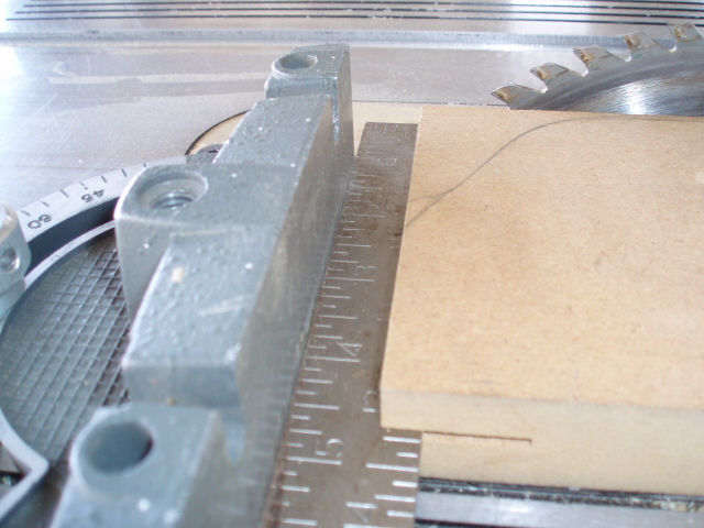

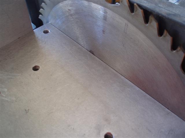

Art,
If there is doubt about the miter gauge, when used in this manner and especially if a Wixey or MiterSet is not available, use a small carpenter's square or an engineering square.
To better communicate:
[ATTACH]6957[/ATTACH]
That "tiny gap" at the blade
[ATTACH]6958[/ATTACH]
That "tiny gap at the fence
The square is held in a kerf cut into two sides of a piece of scrap wood.
