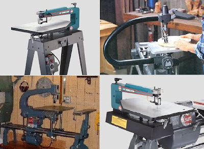

The top left photo is the newer scrollsaw now sold by Shopsmith. It has a quick blade change system and also a clear guard on the top arm.
The top right is the older Jigsaw. It has been discontinued. The older ones were Green, some gold.
The bottom left is the saw for the Shopsmith model 10er. Will not fit the Mark V
Here is the older Gray scrollsaw.

cincinnati wrote:The top left photo is the newer scrollsaw now sold by Shopsmith. It has a quick blade change system and also a clear guard on the top arm.
This certainly sums up the appearances! I overlooked the 'teal' color change. Makes it obvious which version of the scroll saw it is.
Is the base the same for both the stand mount and the ss mount, or are they different? i.e. are the tube mounts and the stand mount/holes common to both? - can they be used both ways if one has all the additional hardware?
