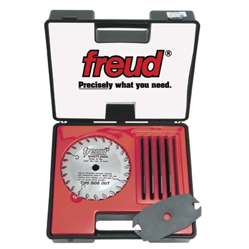

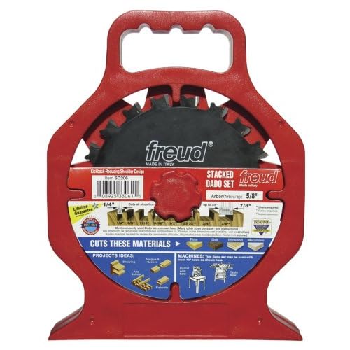

Anyone have any experience with this stacked dado set? I 've read good things about it from multiple sources.
http://www.amazon.com/gp/product/B00002 ... B0000223O8
Heath
Central Louisiana
Central Louisiana
I have the 8" version for my cabinet saw and like it very much.heathicus wrote:Anyone have any experience with this stacked dado set? I 've read good things about it from multiple sources.
http://www.amazon.com/gp/product/B0000223O8?ie=UTF8&tag=thewoodwhispe-20&linkCode=as2&camp=1789&creative=390957&creativeASIN=B0000223O8
