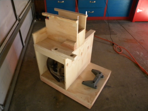

What is in the cubby?shipwright wrote:Space issues in my garage shop in AZ spawned this mobile storage cart. Maybe something like this would be a help.
[ATTACH]7565[/ATTACH]
[ATTACH]7566[/ATTACH]
[ATTACH]7567[/ATTACH]

It will eventually be two drawers, one for my universal tool rest and associated lathe parts and the other for bandsaw blades, sanding belts, etc. The idea started with the measurements of the available space (photo 3) and the idea of the heaviest tool gets the shortest lift. After that there wasn't much design leeway. form follows function.JPG40504 wrote:What is in the cubby?

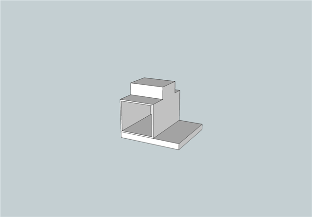

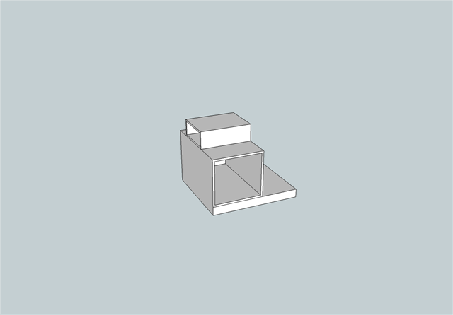

Do these depict (without dimensions being accurate) the basic format of your cart?
[ATTACH]7581[/ATTACH]
[ATTACH]7582[/ATTACH]
- SS SPT Storage Cart (Small).png (20.79 KiB) Viewed 3610 times
- SS SPT Storage Cart 2 (Small).png (20.64 KiB) Viewed 3610 times

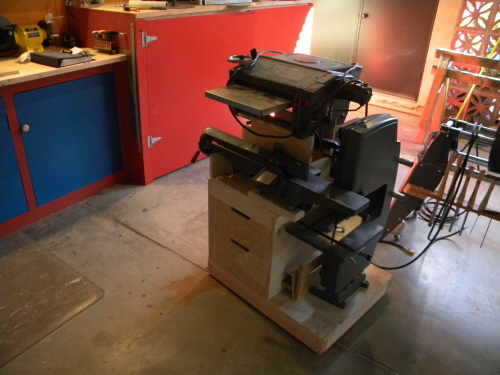

I never make plans on paper so I couldn't say without looking but here's another photo that should help.
[ATTACH]7587[/ATTACH]
If you need more I will get some measurements for you. I designed it as I went by holding the tool up and saying "OK, about there's good". It's the way I do everything. Comes from boatbuilding I think. If you make one, use plate mount casters. I used push in ones and the weight, while within spec for the casters is causing them to "tip" a little in the 2 x4 pad underneath.

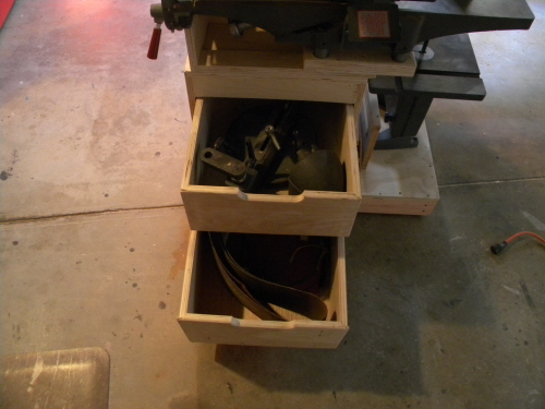

I have to thank you for giving me the much needed kick in the pants. The "cubby" as you put it was indeed planned to be drawers but if you hadn't brought it up the job would likely have remained on the old to do list for a long time. As it is I have a new storage spot for my Universal Lathe Rest stuff and my other SPT accessories.
[ATTACH]7639[/ATTACH]
[ATTACH]7640[/ATTACH]
[ATTACH]7641[/ATTACH]
