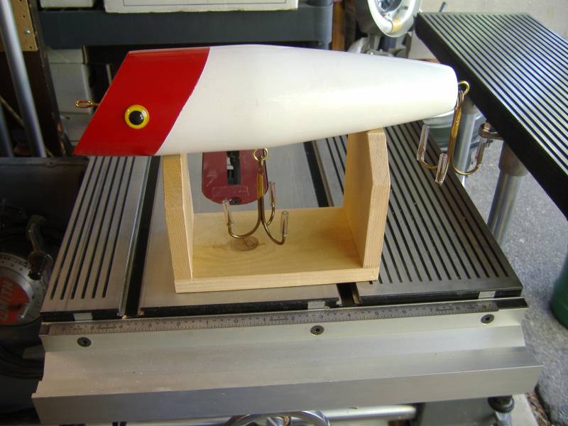

This has been an interesting experment. I managed to learn a few things and for that it was worth it. I'm doing as a gift and know I'll not get in the business of making these.
A lot more problems finishing then I expected.... I have a second one turned and shaped with the drum sander that sorts of looks like a river runt and I will be doing a very different paint job on that one..... and if I do ever do more I will used a different wood, the cedar is just to soft.
I may have miss lead you about this lure... it is for catching people... take a look and see if you were caught.
- done now.jpg (69.93 KiB) Viewed 11283 times

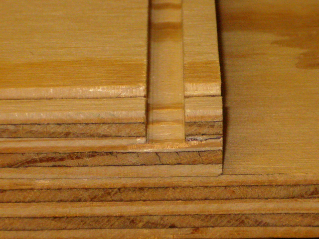

Try this with both your wobble and stacked: Turn the speed up and move the workpiece slowly. "N" for the stacked and "O" for the wobble. Since the blades are smaller in diameter, the surface speed of the blade tips is a lot slower than the 10" saw blade. The faster blade speed along with slower wood movement should give you better cuts. This increased speed also ends any of that feel of vibration that some have complained about. Since there only a few teeth on the wobble (16), slower speeds allow you to feel the strikes of the teeth. I think the Sears stacked dado is a little larger blade than the SS wobble.john wrote:Ed:
...I see you get pretty good results with your wobble blade. I have the SS one but was never very happy with results so I got a Sears stacking dado on sale last year. It's better but still not perfect....

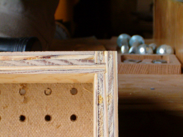

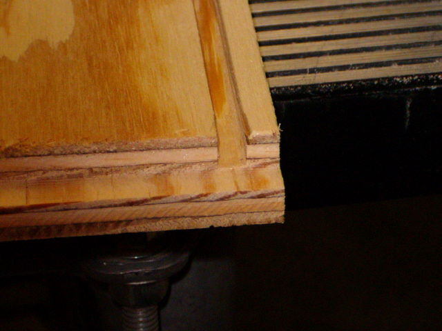

Yes, I think I get real good results with my SS carbide tipped wobble. I ran the 29/32 trial cut through a stain sample, by mistake. (the piece was upside down when I grabbed it) As the piece had been stained and finished with polyurethane - any shoulder chipping stands out like a sore thumb. I don't think I could have done better with a stacked dado (on this finished piece). Believe me, the shoulders are quite smooth. If this hadn't been a finished piece, don't believe we would have noticed anyside edge shredding. (Can't feel any!) Anyway a couple of passes with 220 would have removed them. The bottom of the dado is quite (not perfectly) flat. About .002" off of flat. The 1/4" grooves and the 3/8" dados are pretty flat bottomed too. (Kinda like some folks I know) Joint? not perfect but O.K. for a shop cabinet!
- 3 eighths wobble dado.jpg (162.42 KiB) Viewed 11277 times
- one qtr. dado groove & three 8ths rabbet.jpg (161.92 KiB) Viewed 11277 times
- corner of door not perfect, but O.K..jpg (108.63 KiB) Viewed 11280 times
