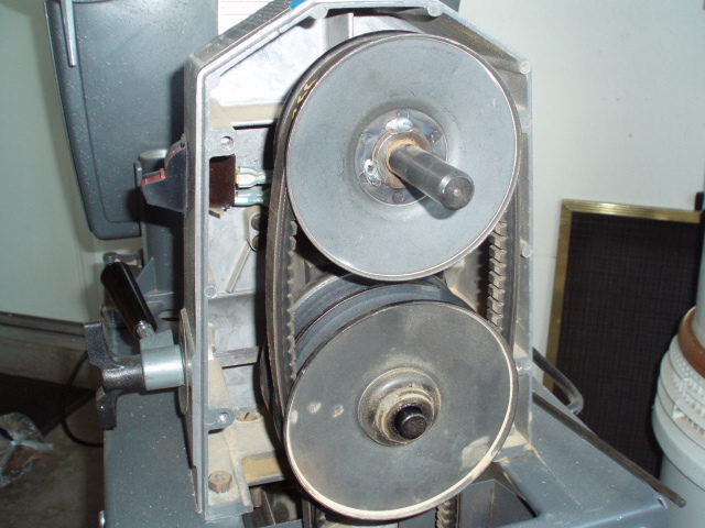

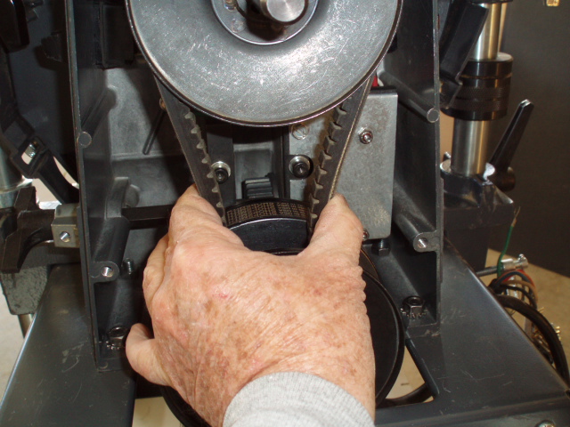

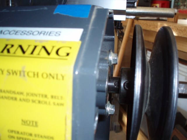

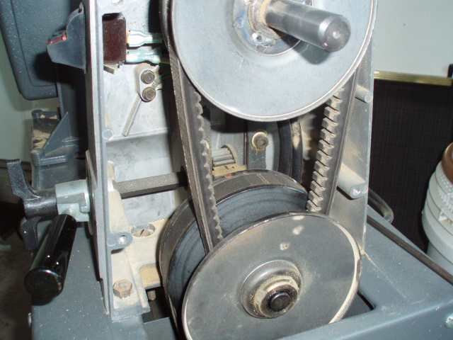

I will try to answer a couple of your questions about the Power Station (comments also apply to a Crafters Station).
I do not have to change the motor mount position to remove and reinstall belts. I remove the small pulley (off the end of the shaft) with the belts in place. To do this I change the speed control to High Speed. This loosens the back belt enough to allow the pulley to be pulled off the shaft.
Once that is done, the belts are very easy to maneuver on and off the pulleys. The speed control can now be changed at will.
You can see from these pictures that the belts are never really tight. There is a lot of slack in the belts and I suspect that slack contributes to the noise level when the unit is running.
One could pull the motor belt much tighter by repositioning the motor but there is NOTHING that can be done to modify the tension level on the other belt. That tension is set by the natural positioning of the sheaves.
I can not tell you how the belt tension was when the units were new. Way back then I wasn't smart enough to pay attention, let alone take pictures.
[ATTACH]7790[/ATTACH]
High Speed
[ATTACH]7791[/ATTACH]
Low Speed
[ATTACH]7792[/ATTACH]
Set Screw
[ATTACH]7793[/ATTACH]
Belt Tension
