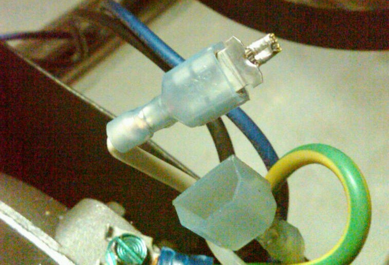

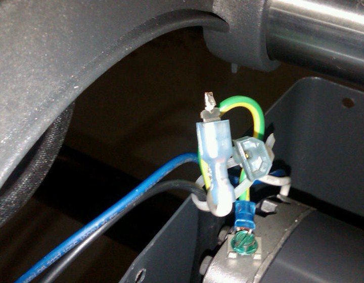

Update! Update! Update!
I found out what is wrong but now I have to talk with SS about how to fix it. The white power wire that is connected to each other was broken on the male side. I don't know if there is enough wire to splice on a new lug but I guess I'll see. Picture should explain better then I can.
I want to say thanks to everyone and I'll post what SS does to fix this or what I do.
[ATTACH]7772[/ATTACH]
[ATTACH]7773[/ATTACH]

I think the appropriate thing to do is for them to ship a new motor immediately. That will give you a shipping container for you to ship the 'defective one' back. They should pay shipping both ways. IMHO
P.S. Nice Pix!
